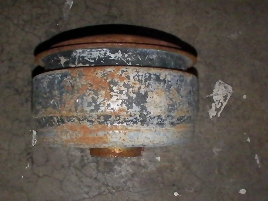

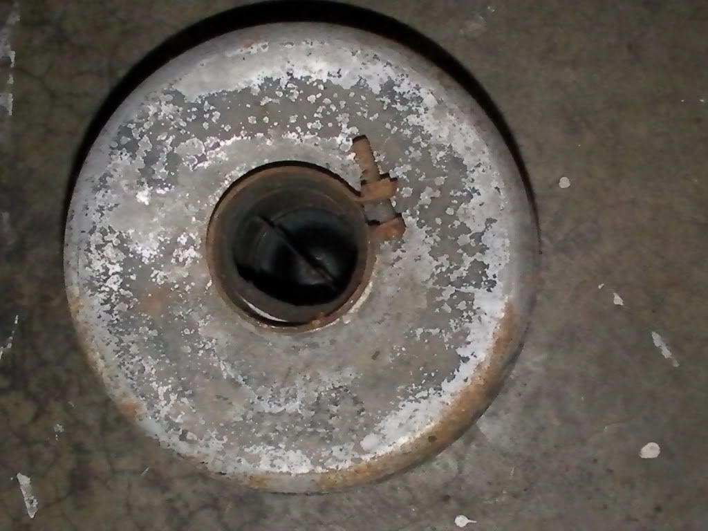

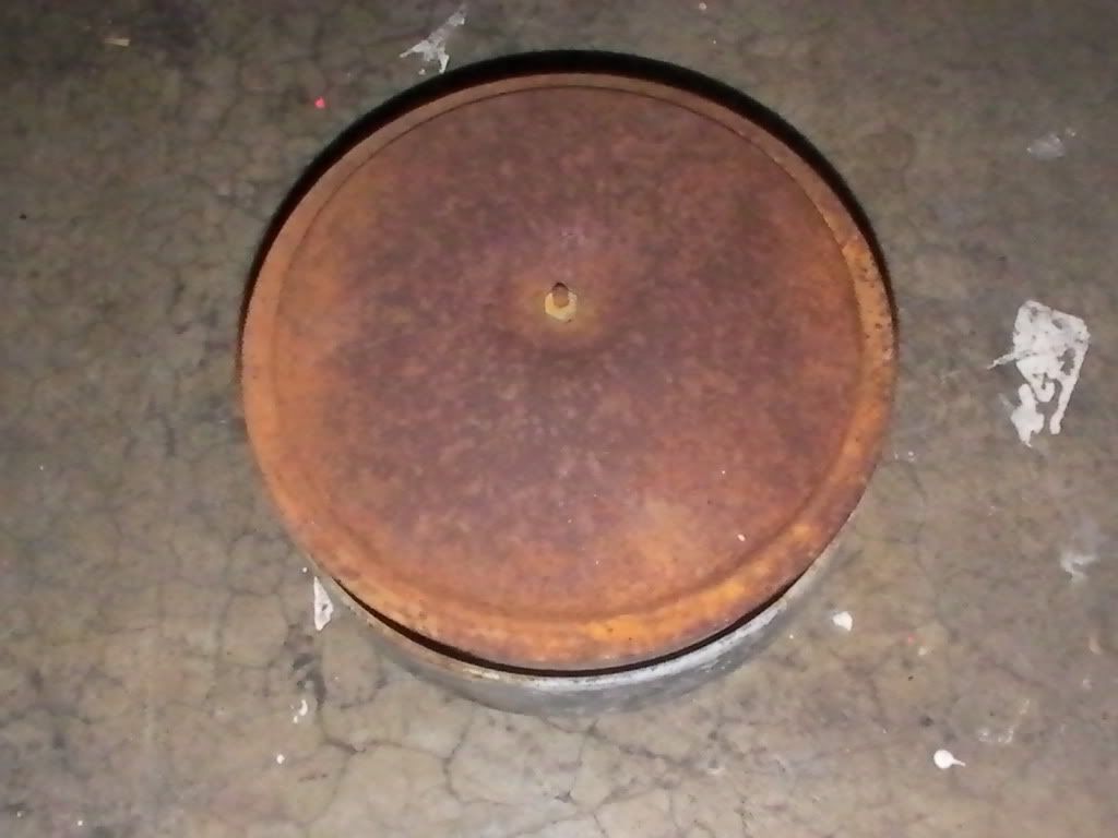

As mentioned in another post I am trying to clean up some parts and make some headway. I started cleaning up this air filter and couldn't figure how to replace the actual filter element and it doesn't look like either one of the ones in the shop manual. So i started looking through the web for pics of oil bath air filters and came across one on ebay that looks pretty close to mine but its listed as a ford air filter. What do you guys think?

yours looks somewhat like the one on my 60 chevy c20 and its a oil bath so you don't replace anything.

Looks like a Chevy to me.

Fords usually had the long butterfly bolt. However, if it fits your Chevy, it is a Chevy.

With that tapered clamp ring it looks like a Mopar filter for a single-barrel Stromberg carb for a flathead six. It's supposed to have the long bolt with the key-shaped handle like the one on Epay.

The filter element never gets replaced?

Wash the filter in solvent and then fill the bowl with oil up to the mark.
