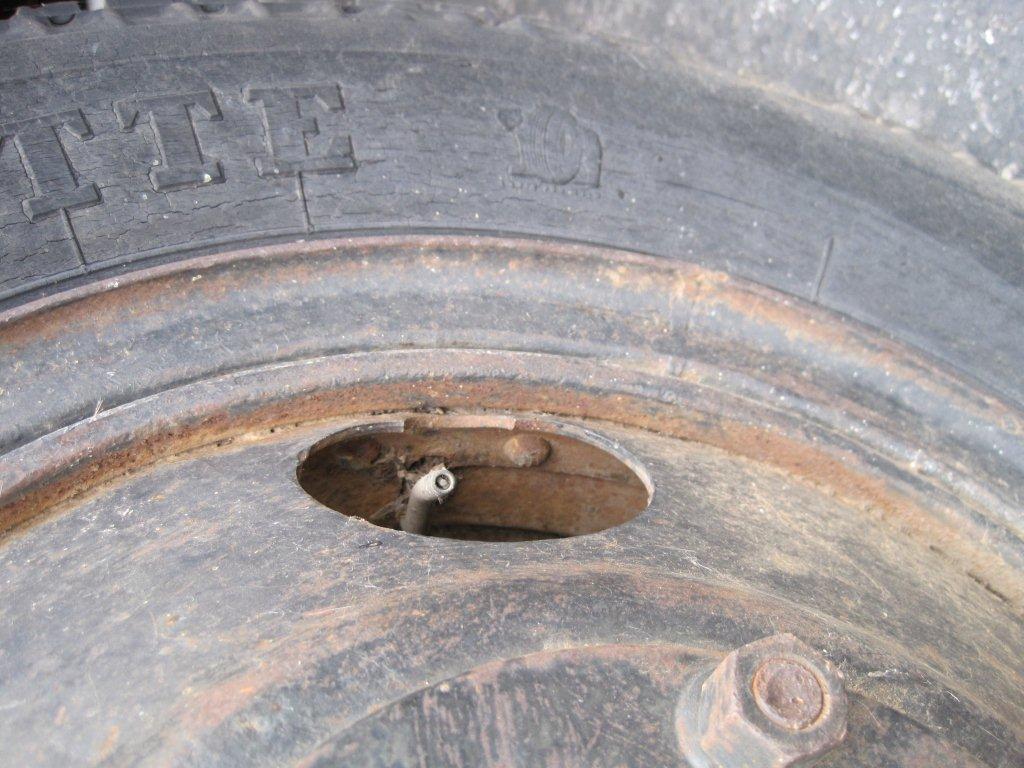

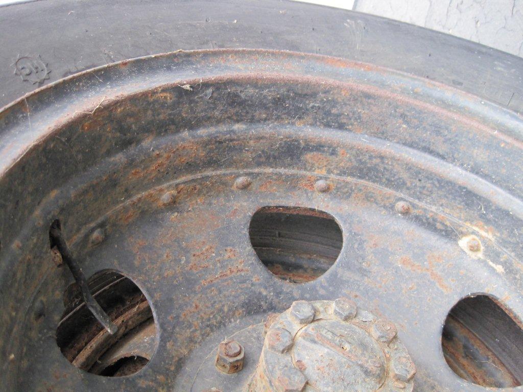

Hello again! Here's a shot of my rims. Follow the link below:
http://i721.photobucket.com/albums/...nd%20a%20Half%20Ton%20Truck/hobby002.jpg
Jeff
Joined: Jul 2008
Posts: 115
Joined: Jul 2008
Posts: 115
Yup, they look like they're probably "RH" lock rings laying upside down on the wheels. Stu

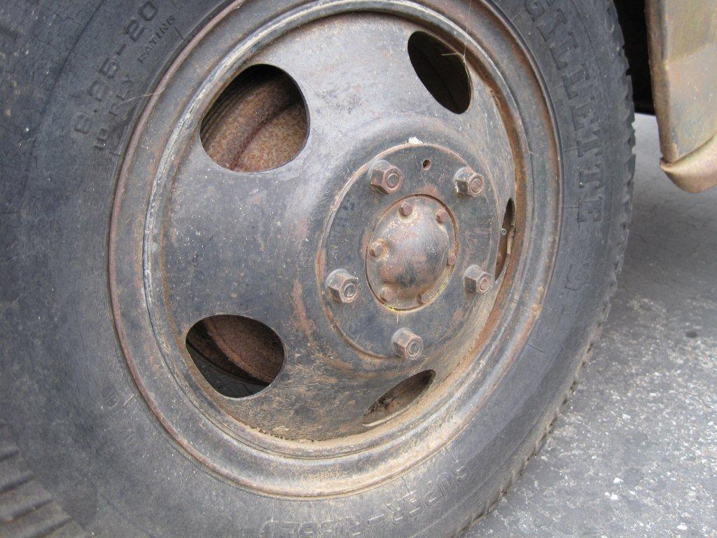

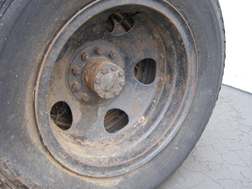

I'm new to these 'widowmaker' wheels, never knew of them till I brought my new truck home. Was wondering if someone can let me know if these are the windowmakers or not. Truck is a '46 2ton
http://cowfast.com/46truck/images/wheel1a.jpg
http://cowfast.com/46truck/images/wheel1b.jpg
http://cowfast.com/46truck/images/wheel2a.jpg
http://cowfast.com/46truck/images/wheel2b.jpg

Joe, I'm not sure but I don't think you have the widowmaker rims. the bad ones are firestone RH5.
Posts: 8,878
Posts: 8,878
Joe_Fish,
Looks like you have 3 piece lock ring wheels, which are no problem if in good shape and handled carefully.
jeffs1936,
Do you have some more pictures? I don't think those are the RH-5 wheels, look more like two piece lock ring wheels, but better pictures will tell.

Posts: 8,878
Posts: 8,878
Yep, looks like a wheel.
Inspect them as recommended here on page 42 and 43
http://www.accuridewheels.com/completeversion.pdf
