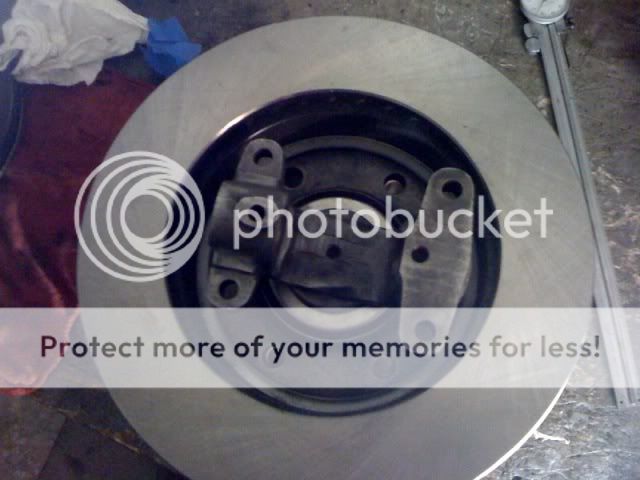

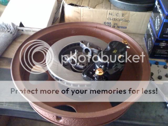

Some of you may be interested in what I am currently working on for my 1936 1.5 ton axle.
I am using gm 6 lug components.. which is the same pattern as the old drums
I started with rotors from a escalade/tahoe..(they are 12" rotors) and turned the bore diameter from 3.125" to 3.8" this allowed the rotor to fit over the hub..
http://i385.photobucket.com/albums/oo291/mack1416/Brakestop.jpg
I then reversed the studs that were used to mount the drum.. I am using 3 tapered lugs and 3 nuts with locks to mount the rotor. The tapered lugs will insure that the rotor is perfectly centered.

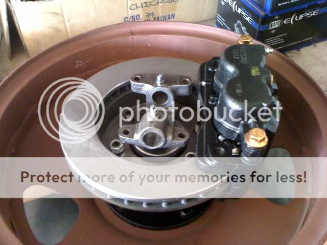

Then I picked up these massive calipers from a police addition tahoe... they are dual piston...
You can see in this shot that the rotor is bolted on as well
http://i385.photobucket.com/albums/oo291/mack1416/Calipershot2.jpg
http://i385.photobucket.com/albums/oo291/mack1416/Calipershot1.jpg
Next step is to fabricate some caliper brackets...
These brakes are going to be a necessity with the highway speeds I am planning.. some of you may remember the rear end conversion i did on my truck...
So far this brake conversion has been pretty painless..Ill keep you guys in the loop

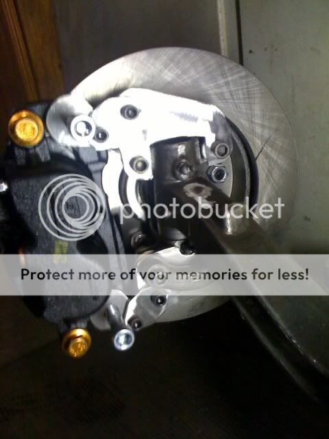

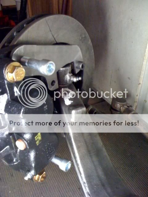

Well things are looking up for this conversion.. I made some quick brackets they are off a bit but i was able to hang the caliper and swing the steering
Ignore the bolts hanging out.. only M14's i could find on short notice
http://i385.photobucket.com/albums/oo291/mack1416/Brakeshanging1.jpg
Here is full lock making a left turn. I hung the calipers to the front
http://i385.photobucket.com/albums/oo291/mack1416/Brakeshanging2.jpg
Next is to finalize the brackets and make them extra beefy.. im thinking i am going to double up 1/4" plate.. and then maybe add some ribs if there is clearance

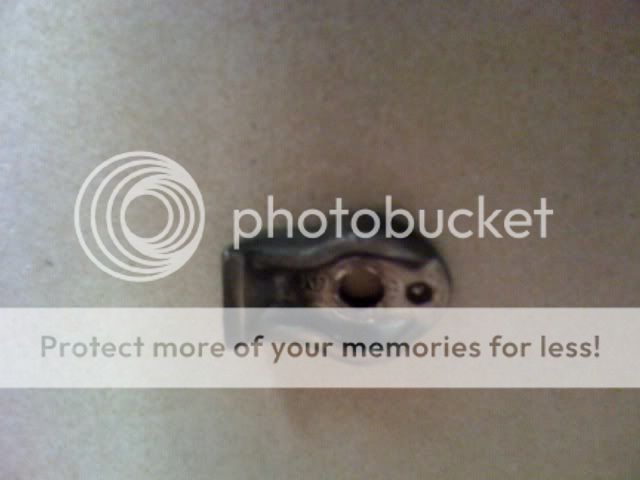

This is the steering stop i am looking for
http://i385.photobucket.com/albums/oo291/mack1416/SteeringStop.jpg

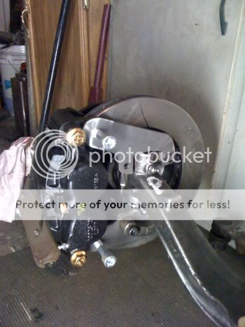

Little update.. i was having a difficult time getting the caliper placement just right. So i made some adjustable brackets by cutting apart my other attempt at brackets and put a spanner piece in between and threaded and tapped the holes. I then adjusted the placement, tightened the screws. Now i will remove them and transfer the holes to a fresh piece of steel and draw out a profile.
http://i385.photobucket.com/albums/oo291/mack1416/Adjustablebrackets.jpg

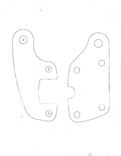

Wow.. been a long time since I dug up this thread. I had a request for the caliper bracket patterns, So I thought I would add them here for anyone else.
http://i385.photobucket.com/albums/oo291/mack1416/Brake%20Caliper%20brackets_zps76ssszla.jpg
Truck is back on the road as of this summer, still debugging a few things, and trying to get all the backlash out of the steering box. At high speeds she is wondering a bit, and I just cant seem to get it all adjusted out.
She goes and stops no problems. Some of you may recall my truck but for those of you that don't she is far from stock. I picked up a truck that was destine for the scrap heap and managed to put her back together, by combining two cabs and lots of new steel. Besides the custom disk brakes, other notable items would be the custom 1 piece front rims and the custom rear axle with 3.07 gearing which mates to the old wheel pattern.
Anyway the brakes work great,the hydorbooster stops the truck like a modern truck, I havent pushed her to hard yet but I have had her up to 65 MPH and feels nice and stable except for the steering wander. I have recently changed out the tie rod ends, but I am thinking I need to redo a king pin again... Doesnt seem right.
Thanks guys, let me know if there is any questions on the brake design..

would a setup like this be acceptable for my 1955 1.5 ton or is the rotor too small to work on a truck that will be going down the highway at 65-70mph with a load? If so, will this caliper bracket design bolt onto my truck or will I need to work on the design to fit?
Thanks, Richard wink

I don't know what your axles are, however, at some point modern axles with 14" brake discs make sense, Grigg has discussion here about modern front spindles on 2 ton front axle, P3500 HD have D70 and 80 rear axles with modern brakes, 5/10 on 7.25" bolt pattern.
Ed

I'm trying to keep the stock spindles and axle while just making a bolt on solution, the axle swap is a little too much for me.
