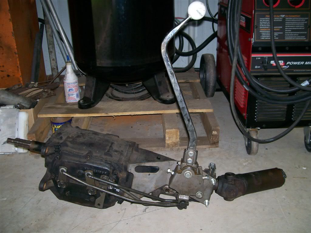

Here's what you need..
http://img.photobucket.com/albums/v...%20and%20differential/Mockedupandfit.jpg
It's bolted to a saginaw. You can get them from Jegs or similar places.
You do have to cut a new hole in the floor, but can normally run it with a bench seat.
Final set up looks like this...
http://img.photobucket.com/albums/v228/Avette4me/My%2058/Passengerside.jpg

I'm pretty sure the shifter is a standard Competition plus. The special parts needed are the installation kit and the shifter.

I've got to the point in my restoration where I really need to figure this shifter thing out! I found that hurst supplies a shifter (part # 3910001), and install kit (# 3737919). What I can't find out is if this will solve my location problem, I'd hate to spend $700, just to have the same problem with a longer shifter! I've spent many hours trying to find info with no luck, does anyone know how to get in contact with hurst's tec dept???? Any guidance or help apprieciated!!

upon second look @ avette4me"s pics it is the same as the parts included with the install kit, I had them both up 2 compare! This site makes these truck easy to figure... and modify smile !!

Bought the shifter and kit. Installed made a big difference! Another step closer!
