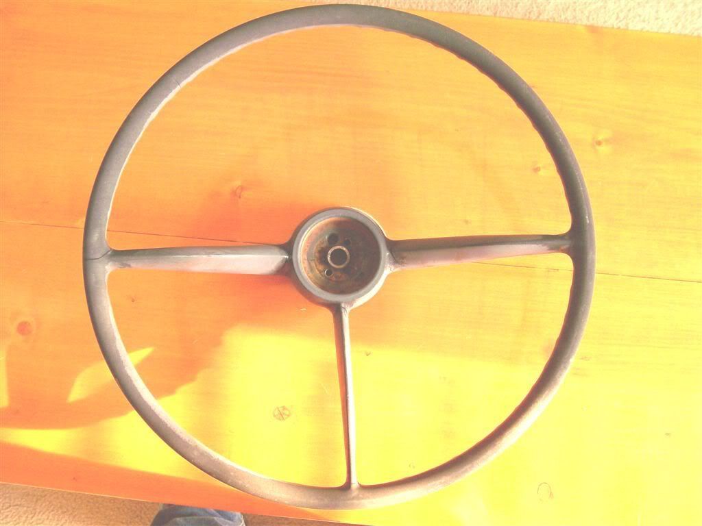

Hello,
I am working on a 58' and the steering wheel is cracked on each of the three braces near the center. It looks as though there is metal inside of the plastic which is fine and seems to be the support. I am thinking about using some type of epoxy to fill the cracks. Has anyone repaired these before?

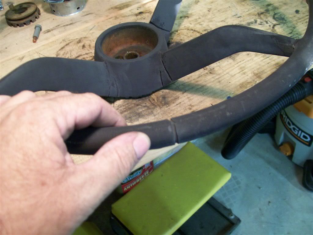

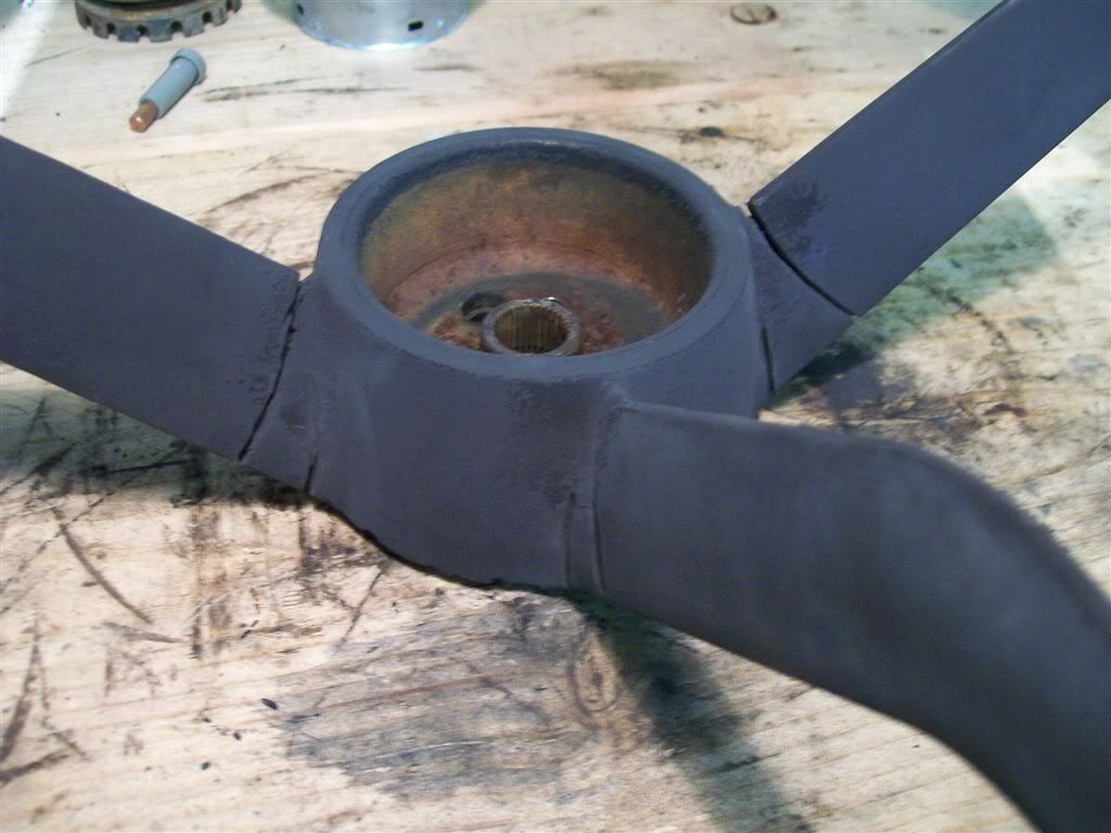

Chances are, it'll crack out just a little after you finish. I V'd the cracks, applied JB in some and a 2 part in others, sanded, primed, and painted with plain old plastic paint.
Started with this (click to enlarge pics)…
[IMG]http://img.photobucket.com/albums/v228/Avette4me/My%2058/Steering%20wheel/th_new-tome.jpg[/IMG]
Sand the entire wheel and V out the cracks
[IMG]http://img.photobucket.com/alb...%20wheel/th_grooveoutthecracks.jpg[/IMG]
[IMG]http://img.photobucket.com/albums/v228/Avette4me/My%2058/Steering%20wheel/th_groove2.jpg[/IMG]
Save yourself a little sanding and smooth the epoxy or JB with a little spit before it gets hard – kind of like caulk..
[IMG]http://img.photobucket.com/alb...20wheel/th_smoothitoffwithspit.jpg[/IMG]
I sanded and painted with a simple can of Krylon plastic paint – been on close to a year now and the paint is still excellent.
[IMG]http://img.photobucket.com/albums/v228/Avette4me/My%2058/Steering%20wheel/th_closeup.jpg[/IMG]
[IMG]http://img.photobucket.com/alb...teering%20wheel/th_driversside.jpg[/IMG]
