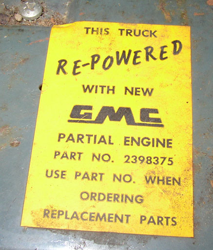

A factory replacement GMC engine (228/248/270/302) has the engine size in cubic inches (and only that number) pressed into the ledge to the rear of the distributor.
The dealer also placed a yellow decal (black writing) on the radiator cover - it stated that a replacement engine had been installed (many of these decals are now unreadable or long gone).
