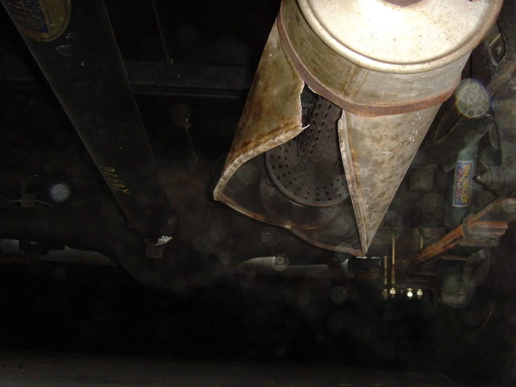

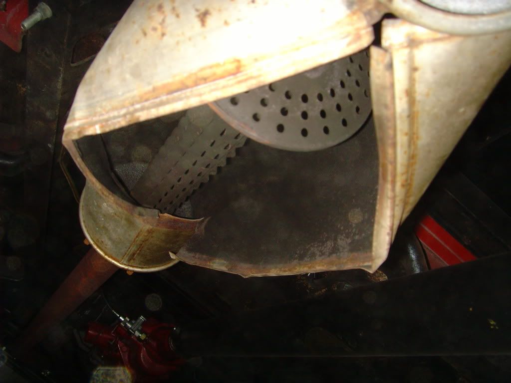

I have been having some stumbling and misfires on my 55.1 recently, but hadn't had time to diagnose it. (Loose wire on coil). Yesterday morning the engine cut out for about 5-10 seconds. When it refired, the muffler exploded!
Here's pix -- looking aft looking forward
I bet it looked spectacular from from the back. It was sure loud in the cab. Oddly enough, the truck still is not horrifically loud. I guess because the muffler split on the bottom.

Muffler filled with unburned fuel while the engine wasn't running. Ignition came back, and BOOM!

Reminds me of an ill-spent youth. We frequently did this on purpose "back in the day". All you have to do is switch off the ignition for 5-6 while in a deceleration mode, then turn it back on without hitting the throttle. Especially effective going downhill. You get a very loud explosion at the least and often blow the muffler out just like shown by Leon. I am almost surprised I used to be that dumb.
