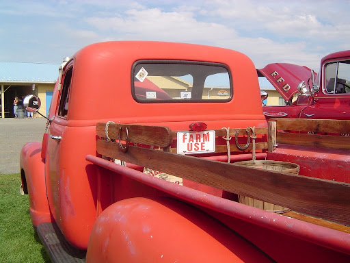

nothing to add except I have met Cosmo in person, what a neat guy and he drives his little red truck ever where..
pix of his truck when I met him
another pix of his great red truck
good luck my friend
