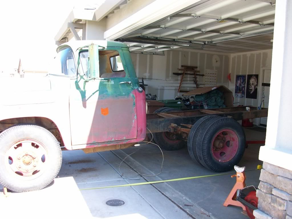

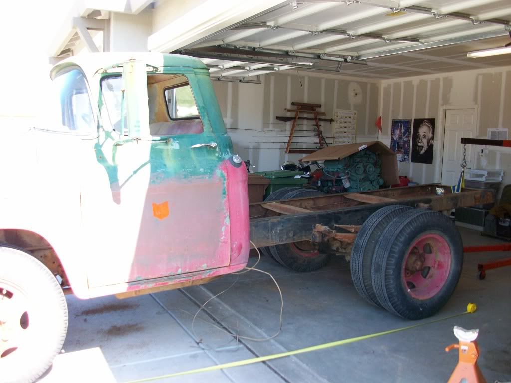

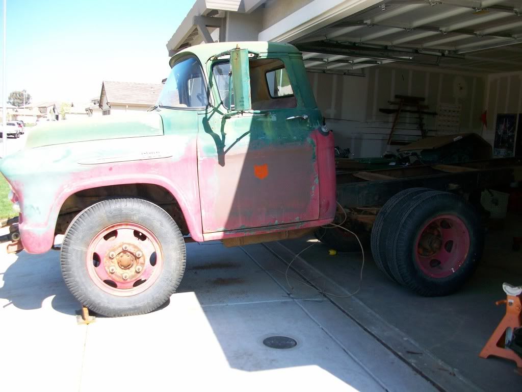

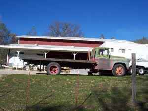

hey guys, i have been lurking for a couple of weeks because i am getting a 56 2ton and have been doing some research.
ive hunted through the gallery several times, google image searches, and posted up in other forums and so far i have really only found resto's and survivors.
has anybody modded out a some of the bog bolts with newer big axles? disk brakes? big deisel motors? custom flat beds?
i have seen lots of $$$$$ c.o.e's that are dedicated show haulers. but most of those are just 73+ dually frames.
i love the conventional cab trucks, especaily the wreckers.
i have some more dumb newb ??? that i will save for later but i was hoping to get some more ideas to run with for now. thanks.
grig has the air start detroit :jealous: and i would like to run a 453 or 6v53. im am looking at bus air bag suspensions and medium duty hydro disk brake axles, i would also like a 3126 cat and a nv5600 but thats wishful thinking.....
[IMG]http://i37.photobucket.com/albums/e53/trkklr77/3m73p63o31fc1411g491if5ebd6fdb90311.jpg[/IMG]
56 2 ton, and never enough time.

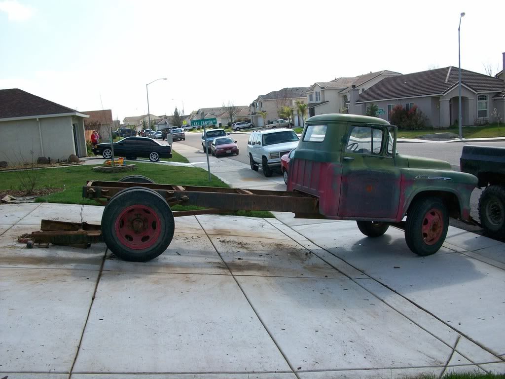

shorten 5'
beaver tail
wheel cups for my 4x4/drag trucks
slide ramps
smoke stacks
hidden/retractable bed crane
i dont want a big block, dont get me wrong, i love them!! but i want something else for this.

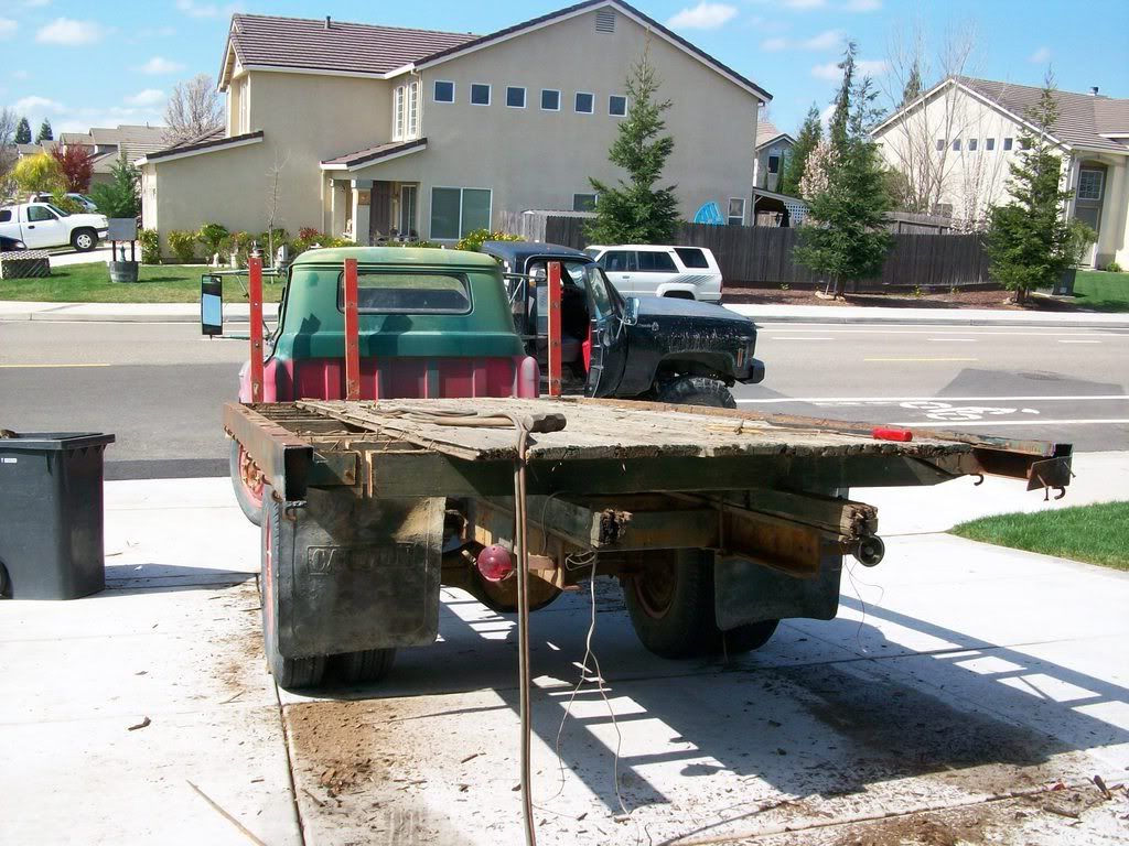

here is a chop pic, im not good enough to add the beaver tail yet.
[IMG]http://i37.photobucket.com/albums/e53/trkklr77/chopped56.jpg[/IMG]

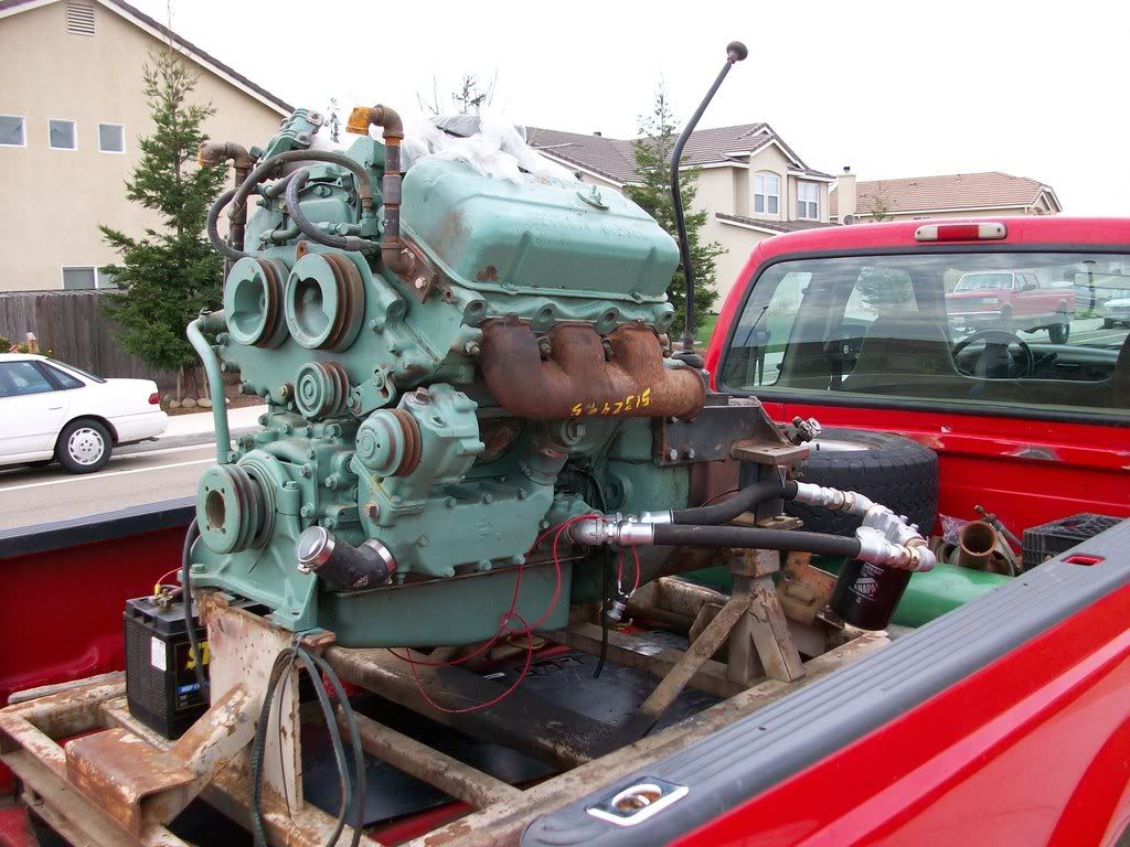

my buddy skinny jason just offerd me his 6v53 with a clark 5spd!!!!
Posts: 8,877
Posts: 8,877
Wow! Sounds like fun.
That'll be a pretty tight fit, but manageable in a 56 I think.
Does it have a turbo?
Is the transmission an OD?
I ask because for the effort involved to install a 6V53, and it's weight you really want the turbo. A non turbo 6V53 has got the same oomph as a 4-53T, which is lighter and a good bit smaller, making it usually the better choice between the two. Obviously if the 6V53 has a turbo and it fits the truck then that's a good choice too.
You'll likely need an OD transmission and or some pretty fast gears (low 3.xx) to make it enjoyable on the highway.
Got any pictures yet?

Posts: 24
i dotn have a good pic yet.
its a 1:1 no o/d clark.
with the 40" otr tires i would be good f0r 65 at about 2300 with 5.13:1, which is what i am looking for because i have a line on a f450 front drive axle with disks and 10 lug.
the 6v is a N motor with no turbo but it has a higher compresion that a turbo motor with out the turbo.
it has 45 injectors in it now and i am also getting some 65's. my buddy who is setting me up ran the same 65's in his turbo'd 453 and its was plenty of go power. i might add a turbo or 2 later but not going to plan on it for anytime soon.
locomotivebreath has be talking with my buddy in the past about trans addapting and some other projects.

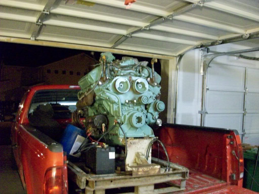

i go tthe motor home, now i just need to figure out how to get it out of the back of the truck!!!
http://i37.photobucket.com/albums/e53/trkklr77/100_0544.jpg
http://i37.photobucket.com/albums/e53/trkklr77/100_0546.jpg
Posts: 8,877
Posts: 8,877
Looks pretty clean!
Few things I noticed right off:
1, Remote oil filter, if you use it the book calls for minimum of 1" flex hose and the matching fittings. Also the filter housing looks undersized, you would want this Detroit housing, and the much larger filter http://rides.webshots.com/photo/2559057530080251109rweveK
Or you could swap the remote adapter for a spin-on filter housing right on the block.
2, The water outlets on the heads should have thermostat housings http://rides.webshots.com/photo/2703896310080251109gPjxtT
3, Didn't see any fuel filters, but ether way, if you want the spin on type the housings are approx $30 each new, you need a primary (before the fuel pump) and a secondary (after the fuel pump).
Looks like fun,
Grigg
1952 Chevrolet 3800 pickup
---All pictures---
Joined: Jan 2009
Posts: 24
2
Apprentice
Apprentice
2 Offline
Joined: Jan 2009
Posts: 24
the oil filter setup is 1". for now i will leave it till i figure out where i will have the best access and clean up mounting spot.
there is a large spin on fuel filter and factory setup post fuel pump and there is a small 5/16" off the shelf fuel filter pre pump. you can see it sitting on top of the motor in both pics.
what i would like to find is the air shut off that it is supposed to have, my inlet looks just like it but its not. i have a huge 8v71 90* 6"diam but i think it looks mhe:/.
one of the tstat housing got broken when the motor go tipped years ago, my buddy didnt have the other on hand. the pipes were setup strictly for stand running and are there just to keep the highest possible water level, they are not permenent.
i was able to get it out, i had to take the trans off and with my lift as high as it would go i had to roll the stand out of the back of the truck and out from underneath the motor. once the stand was off i had all the weight and it held fine, it just wouldnt go any higher to pick it off the stand. the top of the motor from the ground was over 7'.

You might check with these folks for your air shut off. http://www.powerlinecomponents.com/partscat.htm
If you need I can send you some detailed pictures of the shutoff on my 6V-53. It sits right on top of the blower and is spring loaded. The other 6V-53 I have came out of a military APC and uses Halon gas injected into the intake as an emergency shut down.
Sounds like you had fun getting it unloaded without killing yourself, been there myself a time or two. Recently bought a 4000 lb. forklift off of Craigslist for $900.00, should have done it years ago.
1950 GMC 350 COE powered by a GMC 702 Twin-Six V12 / 4L80E combo.

stripped the bed off and shortend the waste from the frame. i still need to move the rear 30" forward fro the 8'bed length.
http://i37.photobucket.com/albums/e53/trkklr77/100_0565.jpg
http://i37.photobucket.com/albums/e53/trkklr77/100_0566.jpg
http://i37.photobucket.com/albums/e53/trkklr77/100_0568.jpg

So do you have to take 30" out of the frame, or just relocate the spring hangers? Looks like your moving right along with the project.

im just going to push the axle forwards and remount the hangers. i would rather do that that cut and splice and create a potentail weak spot in the frame.

That looks good!
Was it any trouble to move the spring hangers forward?
Do you have crossmembers at the hangers tyeing the left side to right side like before?
Looks like your pinion angle might have changed because of the tapered frame rails, you'll want to check and correct that when you get the engine and transmission in there.
Grigg
