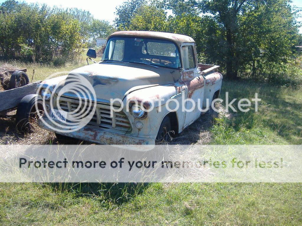

I just brought my 56 home (3A56Sxxxxx) again....sat in a field after a divorce 5 years. Not even sure where to start, Frame is straight, body is not. Right side was hit several years ago. Teardrop is flattened, bed is mangled, all the usual rusty areas. Has anybody used the rear cab skins that are now offered? I have seen them on-line from roof line down and below window body line down, both go from door to door. My floor pan appears to be OK toe boards are not. Quality Parts and ease of fitment are a priority. This is expected to be 3-5 years to complete. Frame has what appears to be primarily surface rust. When I get that far what suggestions can you experianced rebuilders offer to prep/paint/coat for long term preservation/driver. As I rebuild I plan to upgrade the brakes, but keep everything else pretty much OEM.
Thanks in advance for your suggestions.

From your pictures it looks like a lost cause. I suggest selling it to me cheap and get another. grin
Just kidding of course. I have bought a lot of body parts & patch panels from American Classic Trucks and have had some fit good & some that need to be "altered" a little bit. They all need a little customizing I think, no matter where they come from. I have heard Dynacorn makes pretty good panels but have never used them. If I can save a few bucks I don't mind a little cutting/welding/filling.
It is hard to tell from your picture, but if you wanted to replace the back panel because of the right cab corner I would straighten the panel before replacement. Maybe repair the dented area and just replace the lower corner secton. The back panel is about $400 plus shipping and a lot of work. The lower panel is $26.00 & about $15.00 shipping, and no where near as much work. You can check my Photobucket link and see where I have replaced the lower sections.

ya did it fine [but you coulda posted in the general forum], and good luck with the project - always good to see another TF resurrected
I think the cab backs are prolly good quality, being from the same place as the new doors, but I'd get the bed off and make sure you need that much, might be able to straighten a lot of it and use smaller patches, like just the lower corners
for starters, use epoxy primer on everything [maybe ZeroRust or POR on the frame], for the long term, and to protect the work as you go until there's enuff done to use paint .... also prime behind panels and inside spaces as much as possible or use a good rust inhibiter
