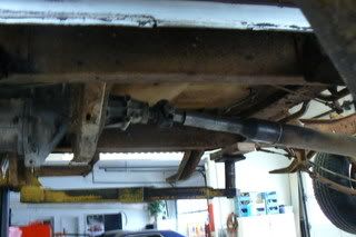

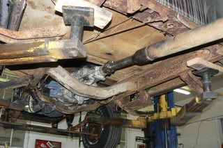

Unsafe,
Your setup is interesting. It also looks like it will live up to your moniker. How is the rear axle kept from rotating and pulling the yoke out of the trans?
Can you post more information or some sketches on you photobucket site?

The tourqe tube yoke is pinned, the T-5 yoke plunges only a 1/2" through the whole susp. travel. How much up and down force can there be way out at the end of the 4' long tube? I was planing on fabing a pivot point off the tailshaft under the yokes. There was lots of reasons to try the 54 car tourqe tube, 5 stud wheels,3.70 gears, same brakes and same park brake setup just bolts together.I just had to shorten it 12", gonna give it a try!

Unsafe,
I like your idea of a pivot. I would still like to see a closer shot or a sketch. I am contemplating a conversion from closed to open, but don't have the time to research it now. I am busy working on getting my 54 back on the road. Of course that could all change if I were to come across a 55 diff.
Keep up the inovative work. I like it.
Take a look at this from TCI, it may give you some ideas about the pivot.
http://www.totalcostinvolved.com/Mustangrear.pdf

Thanks Lonnie. I thought id use the sliding part of the bell for the plungeing part on the tube and fab up a ureathane bushed pivot off the nice through holes in the T-5 tail housing.
