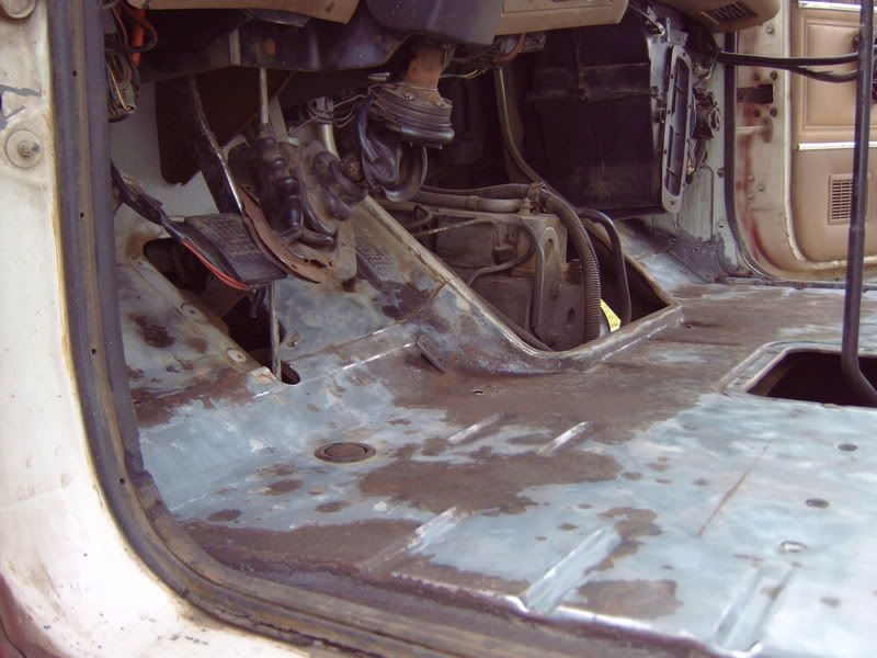

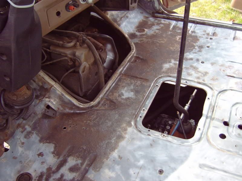

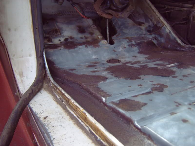

underdog
How did you prep yours? Mine is primed and ready for paint.

I have a couple of weeks before I will need to get it done. I'll check myself and post here what I have found.

For Prep I used a 3M 'Paint and Rust Stripper' (see pic of drill). I was not concerned in removing all the paint, just getting rid of the gloss coat and scuffing up the base coat, however these products will adhere to bare metal.
