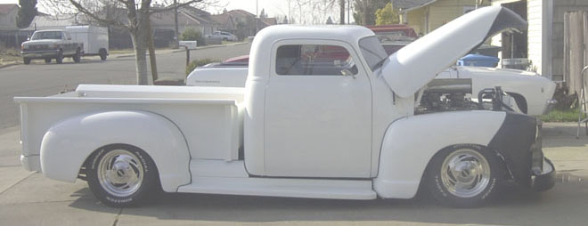

Here's a picture of my truck with the Mustang II suspension. I have to add that I have air ride and the front end would normally be about 2 inches higher.....if that makes a difference smile
[img]http://www.50chevy.freeservers.com/right%20side%20truck.JPG[/img]
Joe

Chevy1- Is that with 2" dropped spindles or stock height spindles?

Tucker,
I am running stock spindles with the Heidts 11-inch disc brake conversion kit and Fat Fendered Street Rods Front and Rear Swaybars.
