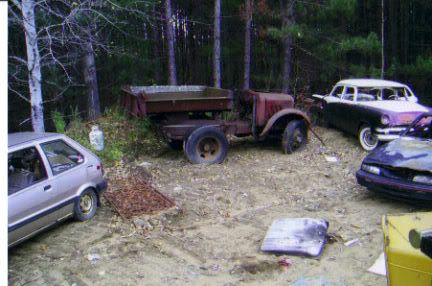

Well I am back with a new idea here goes in the truck I call a Jed Clampett special is a 1955 flat head 6 the gear ratio for the 2 speed rear dif is actually lower in the 53 than in the 55 and it looks like the same tranny. I am not sure if the flat head is 235 or a 261 have not been able to get to it for snow
but would this engine get her up to and maintan 55 mph. The other thing is the flat head 6 is it the correct or did someone bolt up a car engine to a truck tranny or was the 55s flat heads?

I went back to check out your pictures is this http://i256.photobucket.com/albums/hh198/olddozer/hillbillytruck.jpg Jed Clampett special did you mean 35 and not 55? Not sure what you are asking 235s and 261s are overhead valve engines no flathead Chevy’s in 55.

OK now it seems I stirred up a hornets nest but old jed the truck has a flat head motor I will wade the snow and get a pic.
I was told it was a 55 chev drive train motor to rear end.the tranny looks the same as whats in the 53 and the rear axle including the rims and bolt patern are identical to the 53 now I dont want to upset anyone but here is something to consider is it possible that a motor could have been put in canadian trucks but not in US trucks or was it only ford and dodge that had flat heads.Regardless this head is flat and its bolted to a chev tranny if its not a chev engine the old farmer was a darn fine shade tree mechanic and jed the truck is even moreclosely related to Johnny Cash's Cadillac than I thought.

Turns out that the engine is a Green Diamond flat head 6 making it International but it still was married to a chev tranny. Found a big crack in the tranny so as I planned to change the motor and tranny in the 53 anyway I'll put them in Jed the truck and put the green diamond in my dozer works great all the way around.
