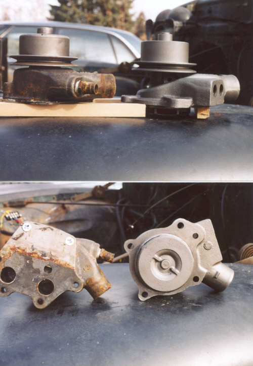

The pump on the left came off my '54 235 ('53 car w/PG, actually) and the one on the right (with shortened shaft) is what I put on my '61 261. I don't know about the newer 235's.

The "official" 261 water pump has dual tapped holes for heater hoses, one goes to the actual heater and one goes to the bypass port on the thermostat housing. Other than that the 235 water pump from the same year will fit and work, you just won't have a place to put that hose. There was a water pump change in '55 from the 216 style with the plate to the late style with the impeller in the block.

I looked at my parts truck with the original pump on it this morning. It has only one threaded hole on the pump and the return hose goes directly to the water neck. So if I understand any 235 pump for 1954 should work on my 261 being as I only have the one hole right now?

Helpful photos. I have both on two different 235s. The pump with two holes and a flush fit was on my 53 and the other with the big impeller is on my 1956 era 235. Unless its not a 235 which I have questioned.

I looked at two of the pumps I have and got the casting numbers.
1. 235 casting number 3774186 no bypass hose outlet.
2. 261 casting number 3757282 with bypass hose.
I think both to be original.
