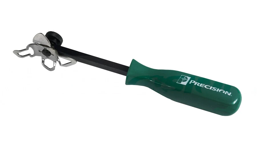

Installing my rear window was a struggle. I did not have that special tool and did it with a simple plastic pry tool. Took me about 4 hours.

My palm was really sore using that flat ended special tool. It worked though, and I can imagine it would have taken me a lot longer without it. My wife was "helping" and it might have taken me less time without her. not me

What does the little eye in the tool do?

The locking strip feeds through the little eye so that as the tool opens the channel the locking strip is fed into place.
Given the advice from this forum I purchased a tool with a large handle (https://i.ebayimg.com/images/g/3vEAAOSwxodgd0JX/s-l1600.webp) and once I got the technic down was able to get my locking strip/window installed in less than 15 minutes. One of learning curve things was removing the extra options for the "eye" piece so that they were not in the way of the tool working as intended.

I didn't think to use a wrench for the locking strip? Saw this on YouTube. LINK

That box wrench trick is pretty cool. The rounded edges of the wrench probably work better than the straight edges that my tool or WICruiser's have. And doesn't everyone have a small set of combination wrenches? I'm not a glove kind of guy, but that probably would have saved my palm. dang

I bought the chrome locking bead for my truck. I wonder if the wrench trick would nick up the chrome?
No worse than the edges of the flat steel tool I used. Added picture from my Journal thread that UtahYork was referencing.

I also used the personal lubricant on my back window. The flat tool I bought had sharp edges that would damage the chrome strip. I had to round out the tool hole with a die grinder and chainsaw file to get it to not damage the chrome strip. I got the idea from the electricians at work they used stuff called poly water when pulling cable though conduit.
