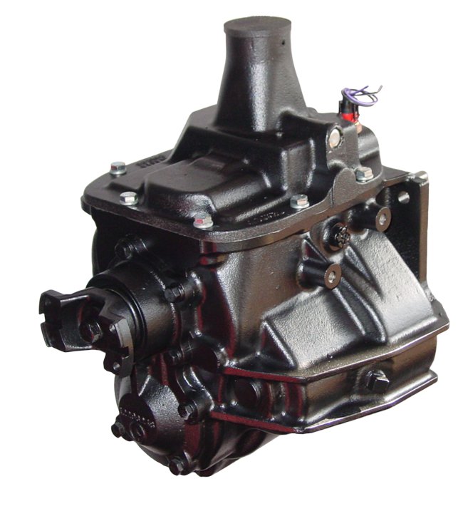

Novak's will modify your SM-420 top cover by drilling and tapping a hole into the tunnel that the reverse shifter shaft slides in and then installing a switch in the hole. Last I checked they would do it for $120 if you supply the tranny top cover. The switch has a ball shaped "button" that the shifter shaft presses on when the rod is in the "reverse" position. I just don't want to tear mine apart.

I like that Bart.
Here is a picture of a SM420 with Novak's backup switch (it is red) installed in the cover.

Yes there are several options. You mentioned you didn't want to break tranny open. So this is one way.
One of the options is don't back up at night. smile
The old long arm brake light switch can be rigged on a pedal arm or brake linkage or on "three on the tree" linkage, depending on truck.
