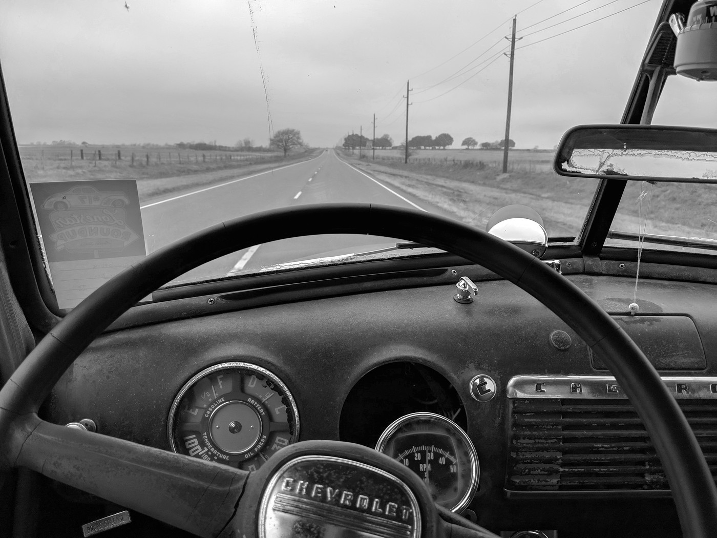

Mine liked 45mph, and on the highway it seemed to favor 58mph. Speedometer has been out of service a while, but here's a tach pic. It would cruise all day. Past tense because it has a T-5 now, and I wouldn't change it back.
https://media.fotki.com/2v2E1CzrSxDubp.jpg
