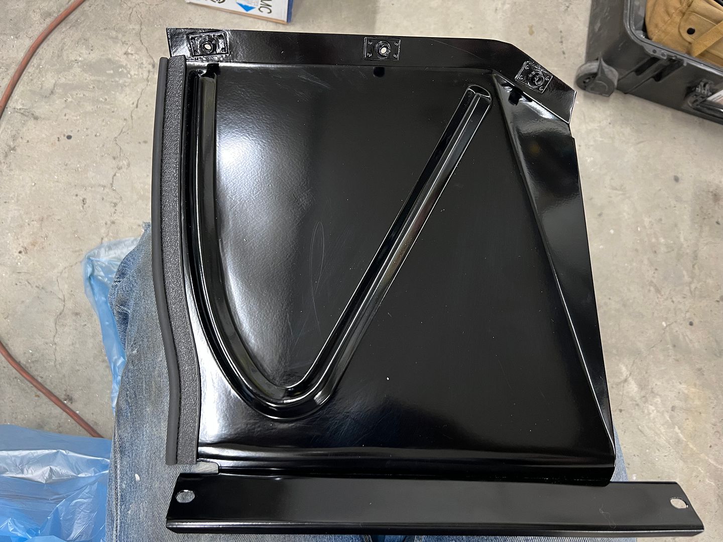

The original metal style are still available. I had to buy one side & had a used one for the other side . I used some leftover rubber from the inner fender welting for the rubber part. While I did use stainless wire for stapes the inner fenders , I glued the rubber to the rear fender seals. The original style clips that hold the metal pieces to the fenders are available as well. I can look back thru my receipts for suppliers, if you need them.
