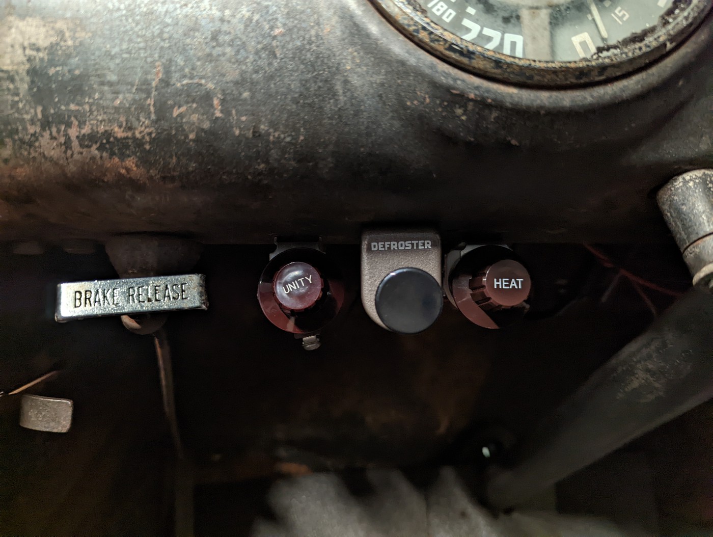

I'm using this switch I bought from Jim Carter (though it's available all over eBay and probably at most of the truck parts places). It lights up like Otto's, but has detents so it has three speeds. I chose it because it matches my lighted Unity fog light switch.
[img]https://media.fotki.com/2v2amKr23xDubp.jpg[/img]
