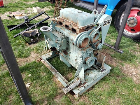

Well, I finally got my little diesel engine home and started prepping it to go in the truck. It's on a stand, so the plan is to get it running and sorted out on the stand ahead of time.
[img]https://media.fotki.com/2v2a3qMjrx3UmAP.jpg[/img]
I know it won't be any increase in power, maybe a little more low end. But I'm mainly doing it for fun and I like diesel trucks.

The nice thing about most diesel engines is the interchangeablity. This engine has an SAE #4 bellhousing, same as Kubota, Yanmar, and a lot of other small diesels.
Phoenix Casting and Machining makes all kinds of adapters and the prices are really pretty decent.

By changing to a #3 bellhousing I could use all stock GM parts, but with the cost of those parts these days it would cost me a fortune.
Phoenix Machine makes an adapter set for the #4 bellhousing and #10 flywheel (which I have). It's only $480 for the set. The advantage of using the Phoenix adapters is that I can use my existing bellhousing and clutch linkage. It moves the engine 3/4" forward, no problem as I have lots of room with the 3 cylinder. The only downside I can see is that you end up with two flywheels, and their weight (in my opinion) will make the engine want to keep spinning and not run down between shifts. The folks at Phoenix say it hasn't really been a problem.
There are a bunch of other outfits making basically the same adapters, but selling them as Kubota to Chevy conversions. Kubota also uses the #4 bellhousing and #10 flywheel. The difference is they are asking a bunch more money for theirs. ($1600 but they include motor mounts).

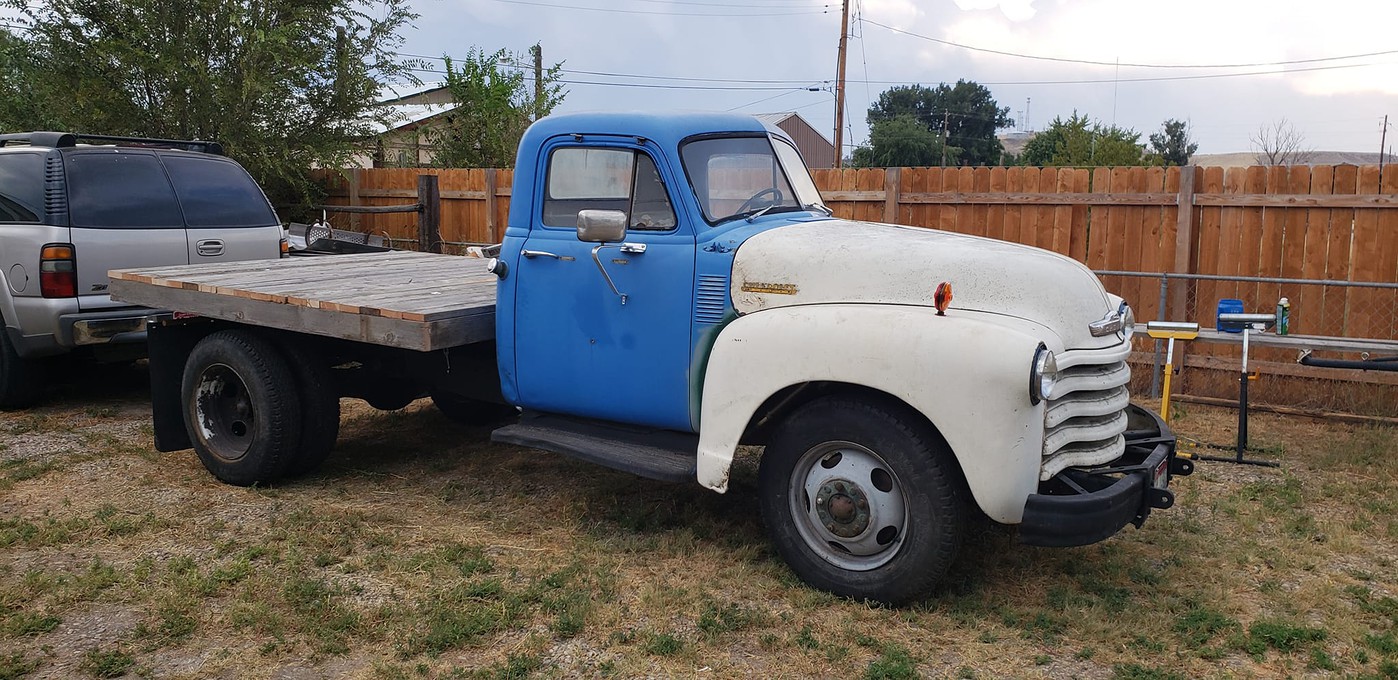

An update on the Detroit Diesel swap.
I still haven't run the engine, waiting on another blower. Some water had gotten into the intake before I got the engine, and froze inside one of the rotors. When it broke the rotor, it locked up the engine. (One reason I got such a good price.) With the blower off, the engine turns over just fine.
After driving the truck with the four speed and the Brownie, I've decided that the gears don't line up that well. I've decided to go with an automatic when I swap in the diesel. Using the auto will also give me a double overdrive.
1953 Chevy 6100 dump truck

Finally got the little engine running on its stand. I want to get everything sorted out before I take the truck off the road for the diesel installation.

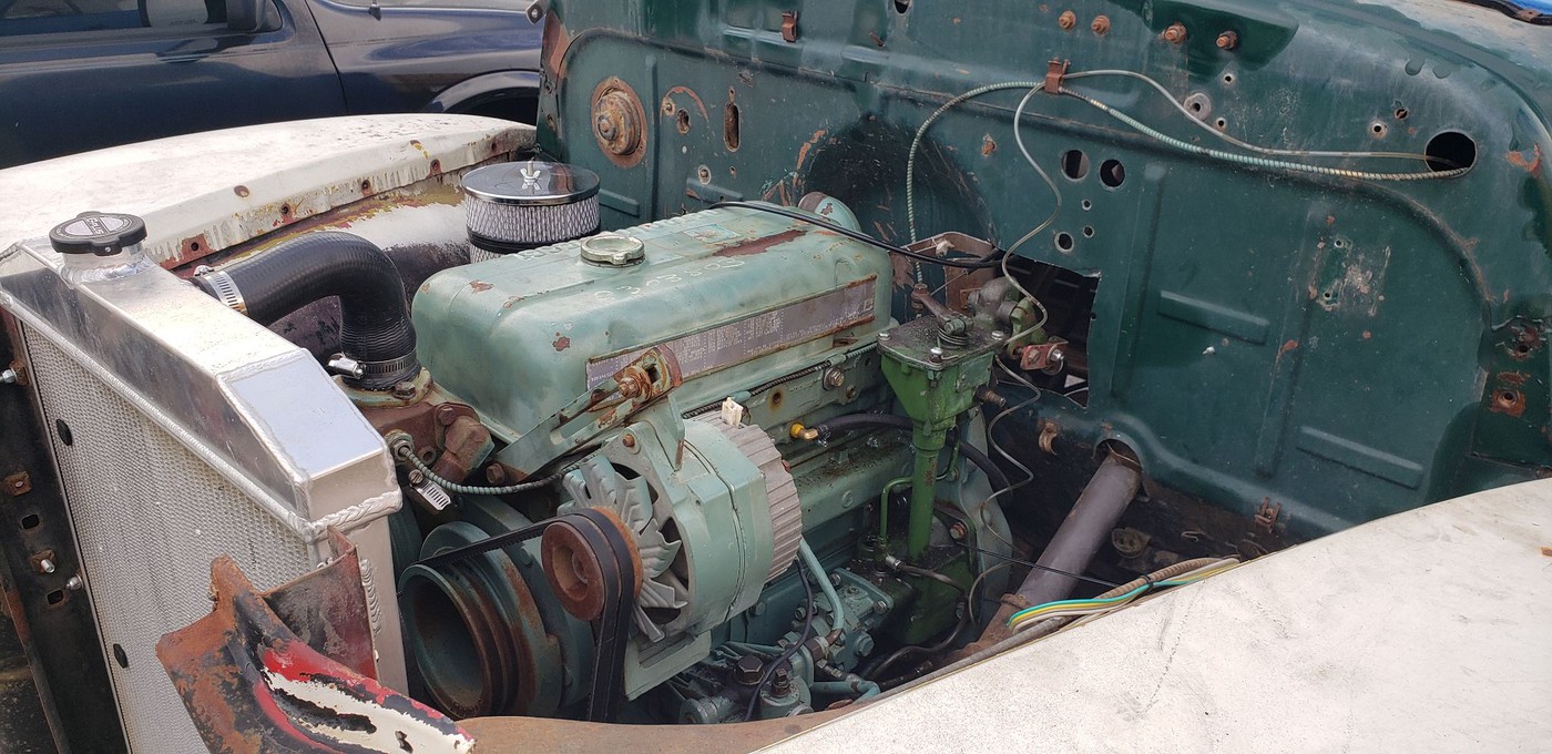

Well, it's been a bit over a year since my last update. The engine is in the truck now and I'm driving it pretty much daily. I made my own adapters and hooked it up to the original 4 speed with the 3 speed Brownie. The little diesel has gobs more torque than the gas engine that was in there. Top speed is an issue right now, I'm only good for around 40 mph. I have a friend that has a P-30 van rear axle, that would most likely have the rear gear I need.
The engine fits into the bay like it was made for the truck.

I found some 19.5 tubeless tires and wheels, and made a temporary flatbed from barn wood until I find a good bed for it.
