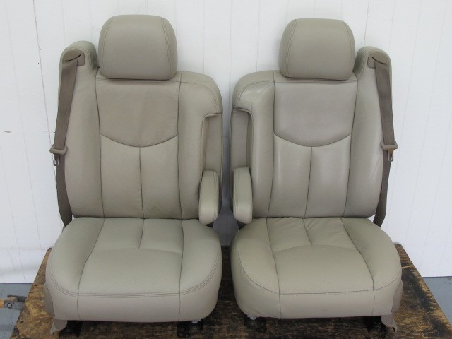

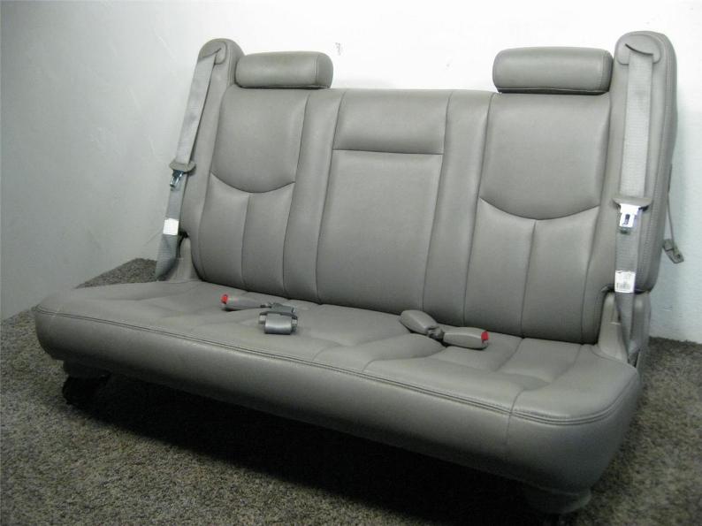

Integrated third row seat 2000 - 05 Suburban Yukon XL Leather Third 3RD Row Seat OEM
Integrated bucket seats 1999 - 2006-Chevy-Tahoe-Silverado-Suburban-Power-BUCKET-SEATS I like these because it looks like you can remove the headrests when not in use for better visibility.
I do not know the width of these or if they will fit without alterations, but I have seen them used before.

when i put the 3rd row seat in my 65 i cut the mounting pockets out of the 99 suburban and mounted them in the floor. that way it is easy to remove the seat if you want to for storage

I changed the information on the seats to show what they are from. If someone could host these pictures they will be saved for future reference ...........g

Those are the seats I've been looking at. Already installed the front seats from a mid 90's Extended cab. They lean forward and then slide for easy access to the back.

Those seats look great. Hopefully Leonard can post some pictures of his install. I would like to have comfortable seats that are easy to install/remove.

i no longer have the suburban what i did was cut the mounting brackets out of the floor of a 99 suburban about 4 "extra. then cut a slot in the floor of my 65 . then made a plate to go under the floor and mounted them with carraige bolts i used the third seat from the 99 sububan. so the third seat mounts just like it did in the 99 suburban
