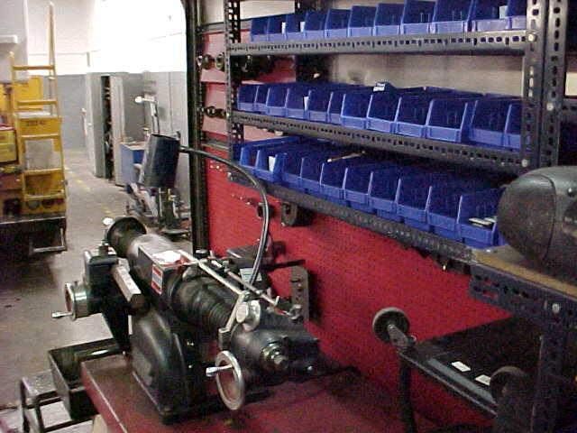

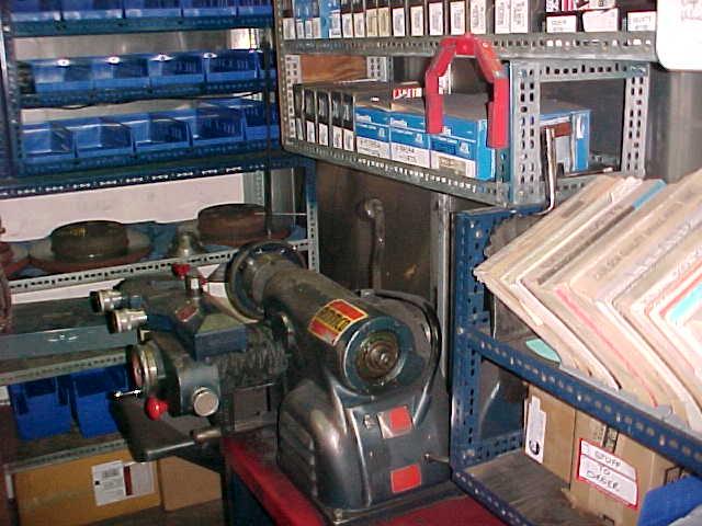

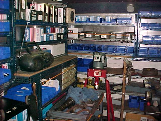

How interesting would it be, to take the 3/4 ton spindle, machine a flat area and bolt the 1998-99 Dodge assembly to it?? That is the way the Dodge set up is! Four bolts hold the "square" rotor / hub assembly to the "spindle / knuckle", (I guess you would call it.) After that, you would have to have an area to bolt the caliper cage to. ( Or do they not have a cage? I forget.)
BTW, my office:
http://www.bunchobikes.com/braketruck1.jpg
http://www.bunchobikes.com/braketruck2.jpg
http://www.bunchobikes.com/braketruck3.jpg
http://www.bunchobikes.com/braketruck4.jpg
Although, I'm doing less of that work these days and more of an all around trouble maker. Like tearing manlifts apart and repairing them:
http://www.bunchobikes.com/pomona1.jpg
Or swapping service bodies on 5 ton trucks. But enough about me. Let's get to the root of this brake problem.
