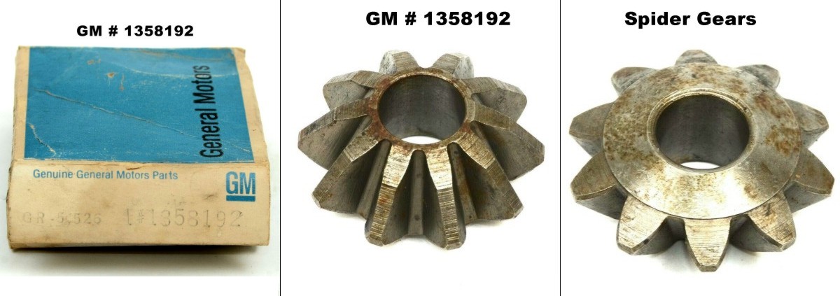

Vegas has ( 1 ) spider gear GM NOS # 1358192
Llewellyn GM Obsolete
Northridge , CA .
phone : 818 - 363 - 5094
Talk to Scott the owner .
Llewellyn has ( 1 ) spider gear GM NOS # 1358192
PIC
https://i.postimg.cc/2yqbyPNN/Spider-Gears-1358192.jpg

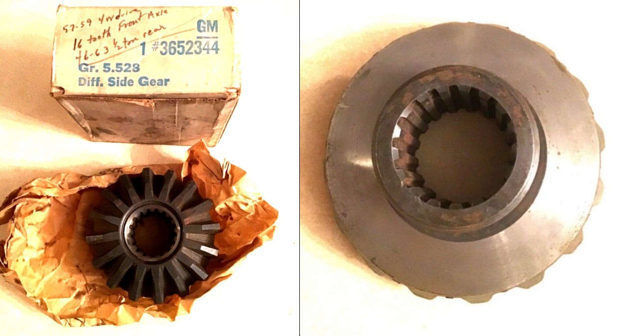

Still looking for the side gears
https://i.postimg.cc/y8hJDmtx/GM-3652344-Side-Gear.jpg

Steve may have ( 1 ) side gear
Send an email to :
Bruce Bugay in Virginia
[email protected]
He may have a side gear
Keep checking ebay a few times a week
Type......... 3652344............ in the search box
