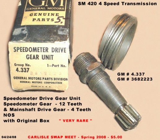

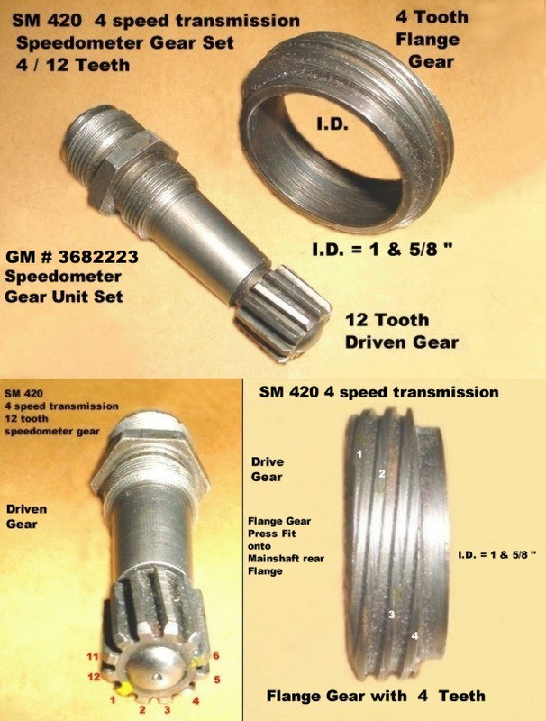

Here's a couple of PICS of a SM 420 ( 4 / 12 ) speedo gear unit .
This one is going to be a hard part to find .
I tried to locate these parts .......no luck .
Put up a part wanted post in the swap meet .
PIC
https://i.postimg.cc/W1Bj1PmN/Speedo-Gear-Set-8.jpg
Here's one I purchased back in 2008 for $5.00
https://i.postimg.cc/MK1743f4/Speedo-Gear-Unit-NOS.jpg
