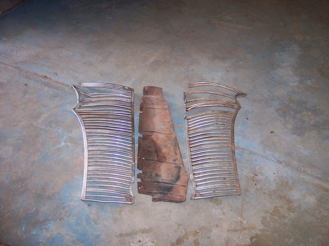

Tiny,... here are some pictures of what I am working with.....

You have an extra grill cowl. The piece at the bottom is where the crank goes thru. There is also a top baffle that has a hole in it for the radiator cap. The front of the hood ornament bolts to the baffle. I had to shorten my top baffle due to using a GMC motor.

Wayne, I notice you don't have the center baffle that goes between the grill halves. Did the truck not have that or did you remove yours? For the OP here's a few pics show the areas of interest on my car. Again I don't know how that translates to the truck. For example the emblem on the car attaches to the grill. If you want pics of specific areas let me know. Once you get your four approved posts you can PM me your cell number and I can text them to you. The images below show, left to right: The aft end of the hood hinge. The center chrome strip is the hood hinge. The connector can be purchased from the on-line part houses if yours is gone. Next, the upper baffle. Next, another look at the aft hinge connection. Next, the bottom left of the image shows the upper baffle and center divider. Next, the core support and lower baffle.

Thank You both very, very much for helping me with your pictures, now I understand how they go together, a picture is truly worth a thousand words..... I am missing just 2 pieces that I will have to track down, the upper baffle and a grill, I do have a center baffle that bolts in between the grill half's… as the partial grill assembly that was with the truck had that intact and on it, but if you know of anyone with an extra upper baffle between the radiator and grill,.. let me know....thank you both again....also I will have a ton of extra parts left over, so if anyone you know need stuff, send them my way, i'd be happy to help anyone out.
