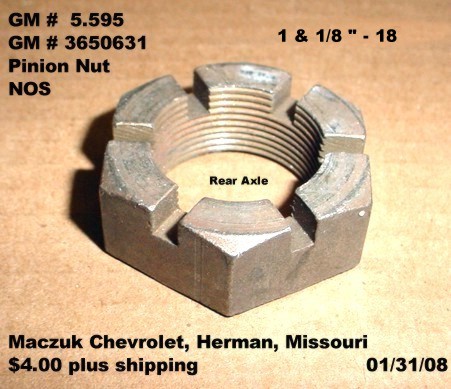

Have a 54 1/2 ton P-U and trying to determine the big pinion nut size prior to me tearing into the diff.
Thanks

I may be wrong but it's a good possibility
this would be your Pinion Nut .
Measure the nut ........it would be 1 & 1/8 " .
If it's smaller........I have another possible pinion nut .
PIC
https://i.postimg.cc/W3xvSsV2/Pinion-Nut-Rear-Axle.jpg
George

I may have used the wrong wording but it is the but it is the big nut on the pinion shaft inside the differential that is peened over to keep it in place.

I believe George is correct. If it’s the same size as a β€˜51 which is 1 1/8” for sure.
