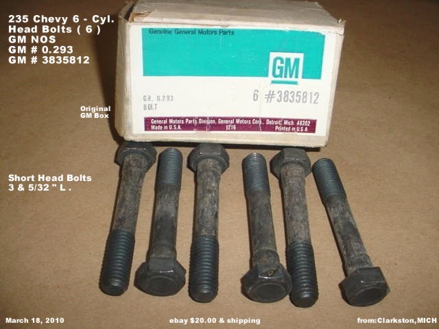

Dan's has
( 19 ) SHORT head bolts - GM # 3835812
( 11 ) LONG head bolts - GM # 3835811
These are GM NOS Bolts .
They are getting very scarce to find in NOS .
PICS
Short Head Bolts - you will need ( 10 )
https://i.postimg.cc/W1yfjBw8/GM-NOS-Head-Bolts-2.jpg
https://i.postimg.cc/qBGC1T3b/Head-Bolts-GM-NOS.jpg
https://i.postimg.cc/37QmQLnr/GM-NOS-Head-Bolts-3835744.jpg
Long Head Bolts - You will need ( 8 )
https://i.postimg.cc/LsZQsxyp/Head-Bolts-12-GM-NOS-3835812.jpg
https://i.postimg.cc/nL49DbYt/3835743-Long-Head-Bolts.jpg
