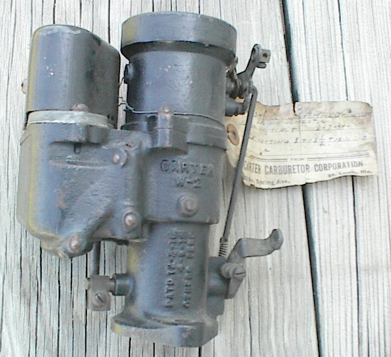

Mike - check this out:
[img]http://www.thecarburetorshop.com/Carter_W2_1.jpg[/img]
Jon

Jon, is this one of yours? It is tempting!

Joined: Nov 2002
Posts: 2,766
Carburetion specialist
Joined: Nov 2002
Posts: 2,766
Mike, yes, it is mine, not currently for sale. In 45 years of searching, I have found only 3.
