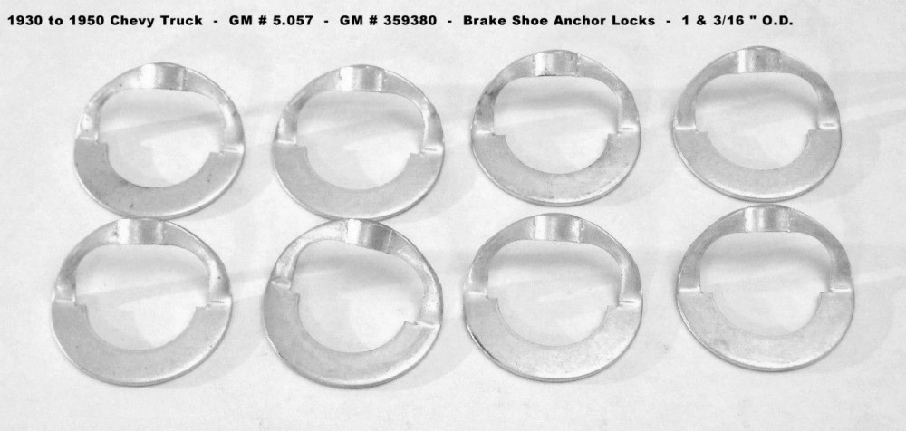

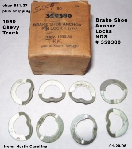

I Believe the Brake Shoe Locks are GM part # 359380 .
1 & 3/16 " O.D.
Check your parts manual .
PIC
https://i.postimg.cc/28vFpDH8/Brake-Locks.jpg
GM NOS Brake Shoe Locks are available .

There are ( 8 ) Brake Shoe Locks on ebay for $9.95 & free shipping .
PIC
https://i.postimg.cc/3r056Yqc/GM-5-057-GM-359380-Brake-Shoe-Anchor-Locks.jpg
Go to ebay & in the search box...........type...........359380 .
