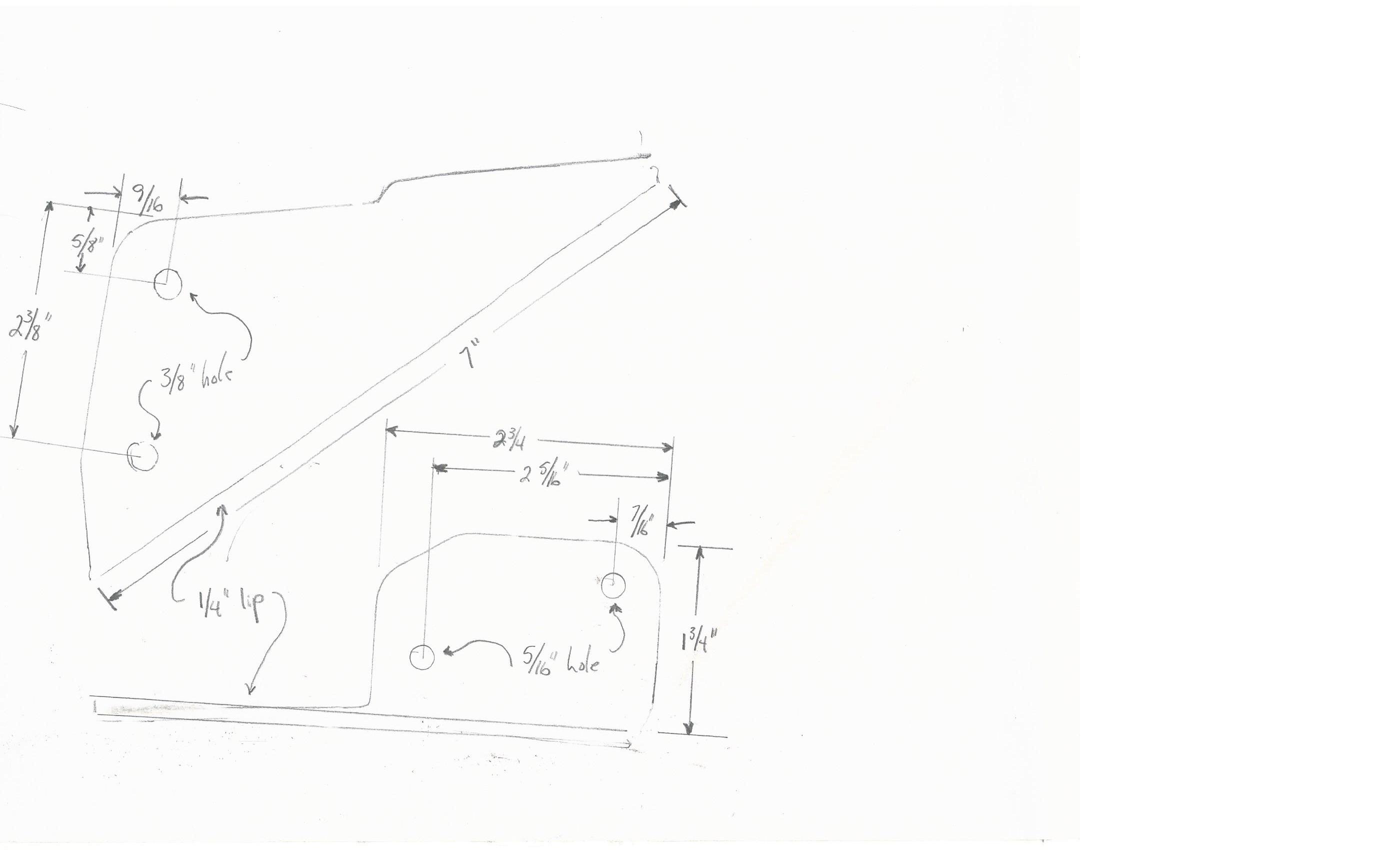

Give me a day or two and I can get you some bracket drawings as I have two off and the other two are coming off today.

This is the drivers side. Passenger is reversed. Hopefully his helps. Let me know if you need more angles or numbers.
Dimensions: http://www.bunchobikes.com/Splashbracket.jpg

THANK YOU so much. It looks like the diagram is all I need but I'll let you kn ow how it comes out. Thanks again for thaking the time to do this. Good Karma upon you!

Hi Mark, I was trying to make a template from your drawing and I'm missing some dimensions. I need the height of the 5/16 holes from the plate edge on the lower drawing and some outline dimensions on the top drawing. The hole dimensions are good on the top drawing just the distances on the side heights / angles and the top with the dip area length. Sorry for the hassle but I need to transfer the outline to the metal so I need actual size of the pieces. It would be great if it's possible to just make a tracing that's life size and I could print that. Nothing easy right! The pictures help me see the actual bend and position so thanks for posting them also.

UPDATE - Thanks Mark for all the help. I have found a source for the brackets so I won't trouble you for the dimensions. I'll use the ones I ordered for a template to make good usable ones. Can't thank you enough though for all the help getting me past this issue.

That would have been my next move. An unfolded tracing with a rule for accuracy when going from computer to printer.
