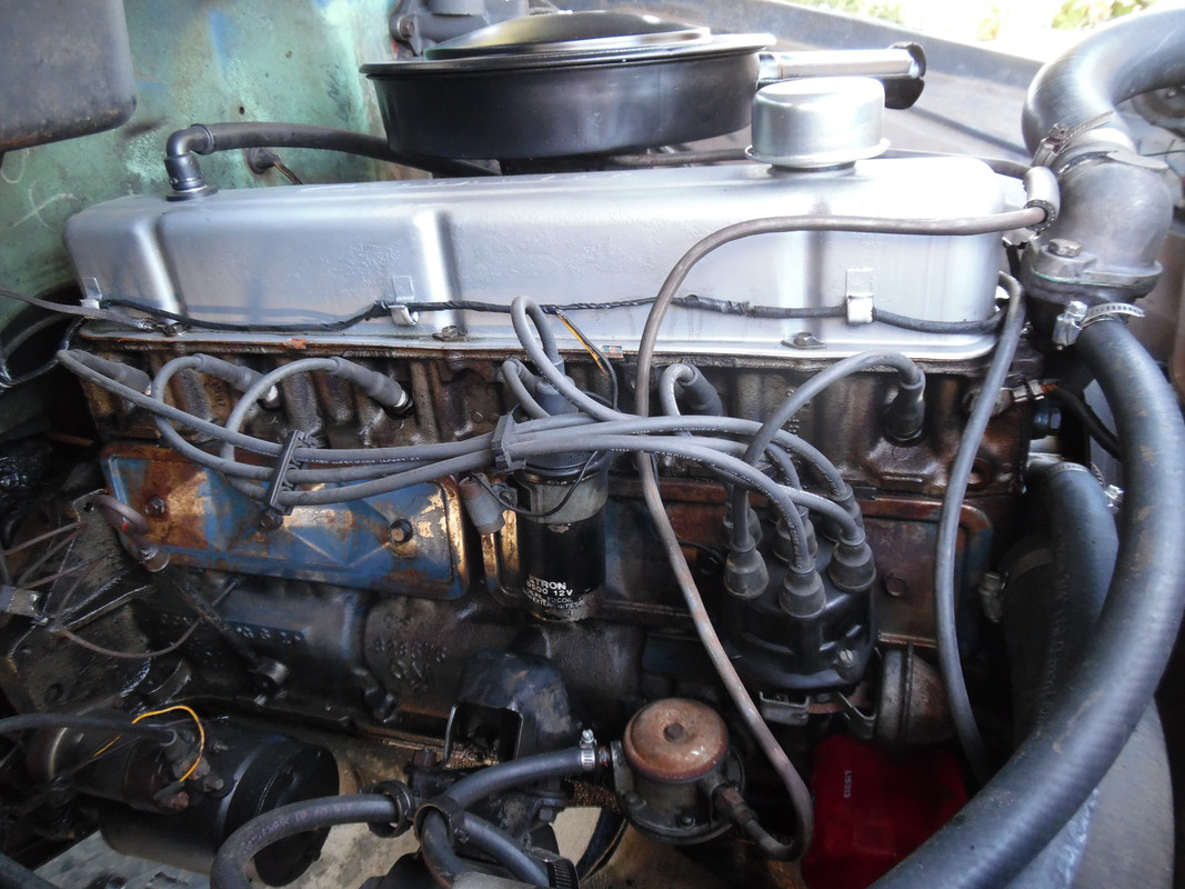

Been having a annoying hesitation/misfire under load at low RPM. 250 I6 engine. Replaced the plugs, plug wires, distributor cap and rotor....no fix. Points and condenser were also replaced recently. Turns out it was a defective condenser...holy crap, a $5 part causing all that BS... dang
[img]https://i.postimg.cc/DyFyzM5Q/SAM-0455.jpg[/img]
