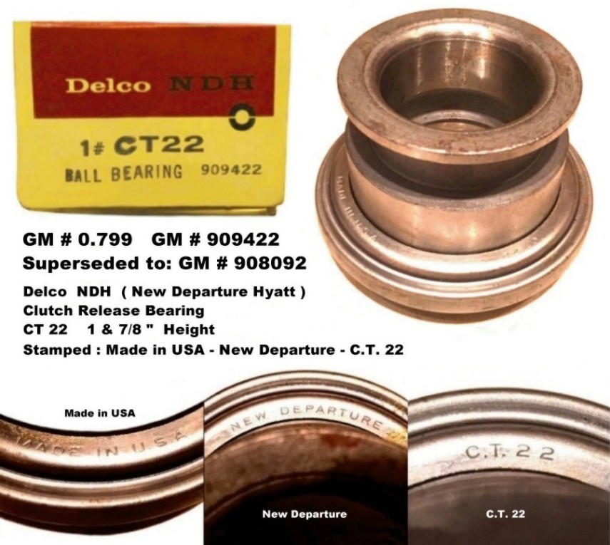

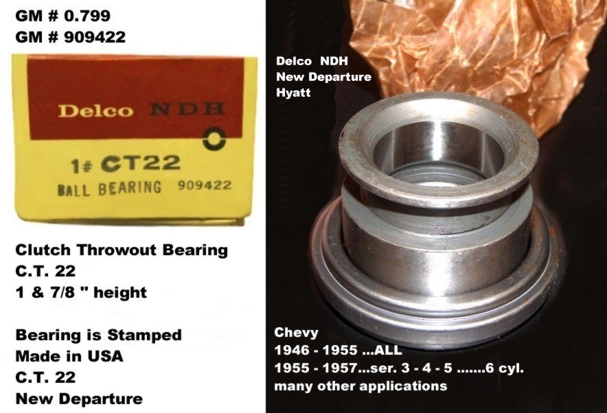

This GM Clutch Bearing is the long one .
They are on ebay often .
Go to ebay & type in the search box...........909422
PICS
https://i.postimg.cc/4NX6CQfQ/CT-22-NDH-Clutch-Throwout-Bearing-909422.jpg
https://i.postimg.cc/Bnrt3J5f/GM-NOS-909422-Clutch-Release-Bearing.jpg
