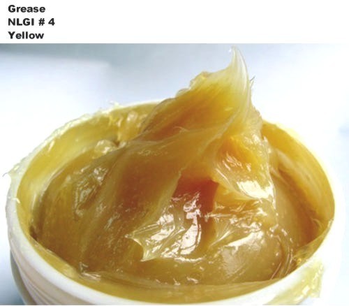

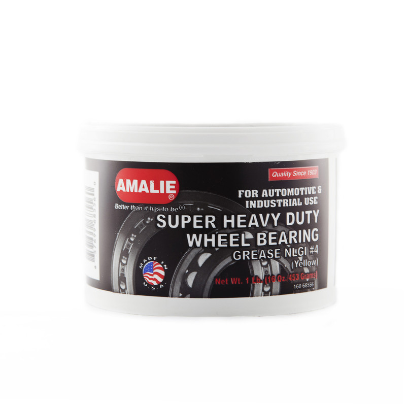

Those ball bearings did not originally use high temp grease. They used high metallic soap grease, or what many would refer to as fiberious grease. It did melt a bit with some use but was better for the ball bearings. Hard to come by these days and I am not even certain it is still made. One thing for certain you can’t get it at the local auto parts store.

This is the kind of grease Dragsix is talking about .
PIC
https://i.postimg.cc/DwXfqPwK/160-68556-93a.jpg
https://i.postimg.cc/jS5YVLd2/lubricant-grease-500x500.jpg
Amalie Heavy Duty Wheel Bearing Grease is highly fibrous sodium grease formulated to provide excellent
lubrication properties for open, heavy-duty bearings. Amalie Heavy Duty Wheel Bearing Grease imparts
excellent resistance to displacement under high loads or centrifugal action. Not recommended for disc brakes.

I'm old enough to remember the fibrous bearing grease. I didn't know it was still available.
When I repacked the front wheel bearings in my 3600 years ago I used a "water proof" grease sold for boat trailers. It worked fine... though it may have been too light for those truck bearings. No failures while I owned it. Sometimes it's better to be lucky than smart. wink
