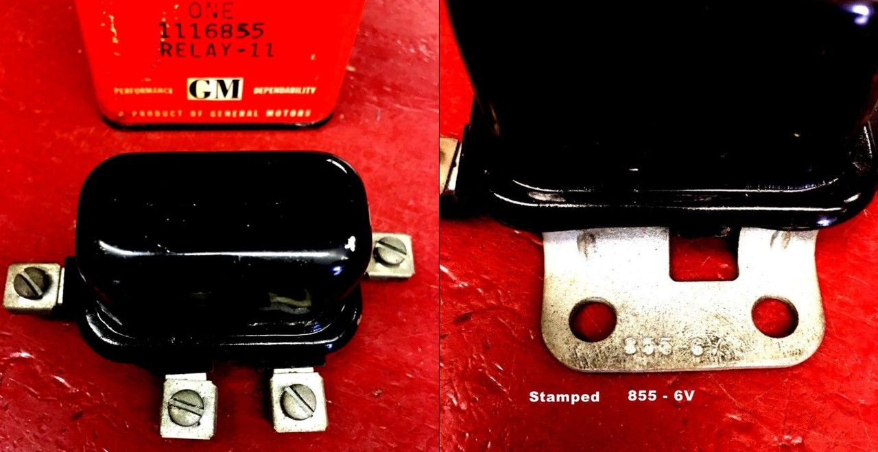

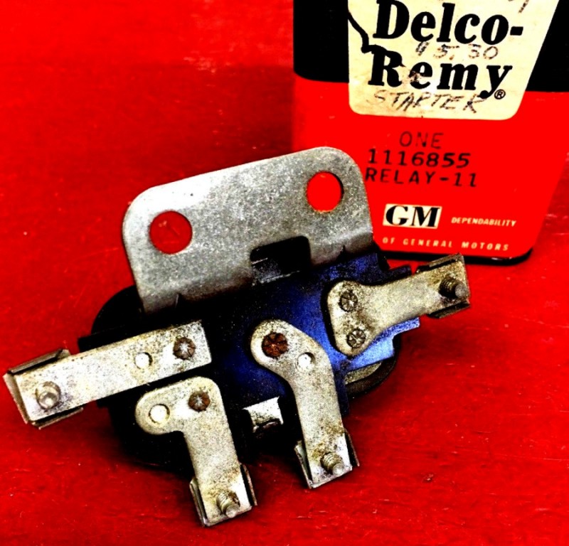

Go to ebay .....&.....in the search box.......type.......1116855
There are a few on ebay for sale .
Chicago Auto Parts
Saint Ann, ILL.
phone : 815 - 614 - 3122
Chicago has ( 1 ) Delco Remy NOS relay in stock.
PICS
https://i.postimg.cc/5yfhPDJx/relay-1116855.jpg
https://i.postimg.cc/y6P4J6hW/1116855d.jpg
George
