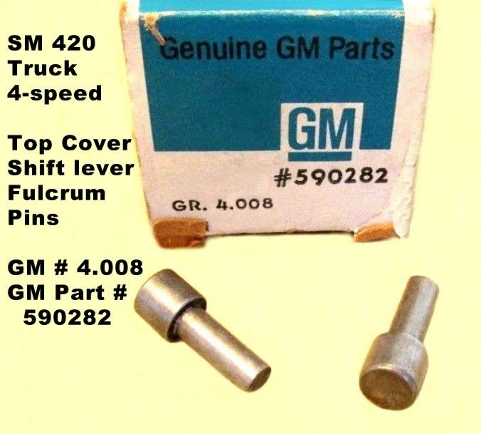

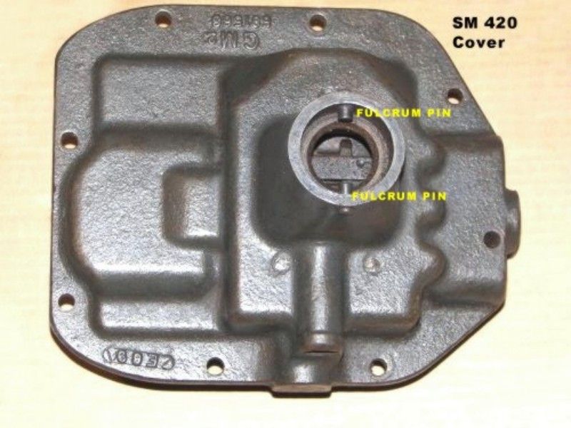

There are a few parts that can be replaced to take the wobble out of the SM 420 4 speed shift lever .
photos @ photobucket
Top Cover showing Fulcrum Pins - GM # 590282
http://i669.photobucket.com/albums/...0Cover/SM_420_Top_Cover__zpsiuyy4pdq.jpg
Fulcrum pins - GM # 590282
http://i669.photobucket.com/albums/...ver/SM_420_Fulcrum_Pins__zps7gma956l.jpg

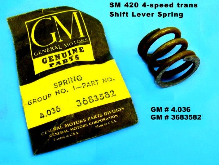

Shift Lever Spring - GM # 3683582
http://i669.photobucket.com/albums/...er%20Spring%20GM%20NOS_b_zpsxurteurj.jpg
Friesens Chevrolet has ( 8 ) Shift Lever Springs in stock
Newton Motors has ( 18 ) Shift Lever Springs in stock

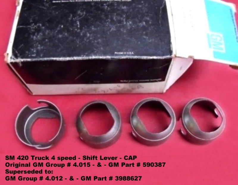

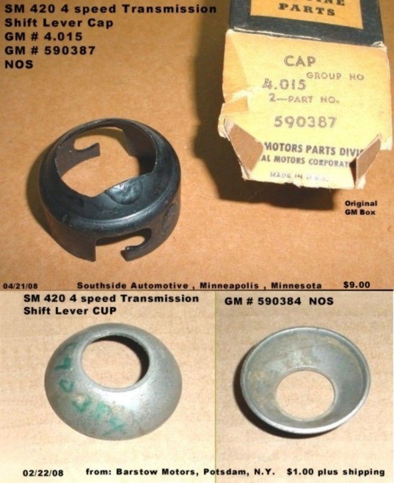

Shift Lever - Cap & Cup ......GM # 590387 Cap superseded to GM # 3988627
http://i669.photobucket.com/albums/...0Lever%20Cap%20and%20Cup_zpsvd7ypc5b.jpg
Friesens Chevrolet has ( 5 ) Shifter Caps - GM # 3988627
http://i669.photobucket.com/albums/...ft%20Lever%20Cap%202%202_zpsy8tdw29r.jpg

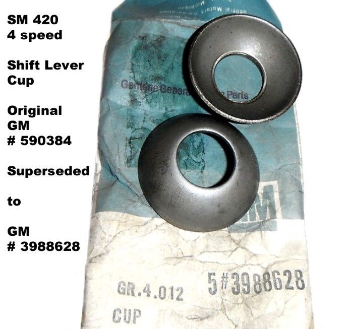

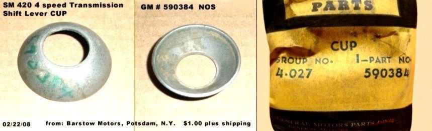

Shift Lever Cup - Original GM # 590384 - RARE PART - very hard to find
http://i669.photobucket.com/albums/...ver%20CUP%20NOS%20GM%202_zps9sh3qmki.jpg
Shift Lever CUP - GM # 590384 superseded to GM # 3988628
Dan's GM Obsolete
Chinook, Montana
phone: 406-357-2615
Dan's has ( 14 ) Shift Lever CUPS - GM # 3988628
http://i669.photobucket.com/albums/..._Shifter_Cup_GM_3988628__zpsijafa9ey.jpg

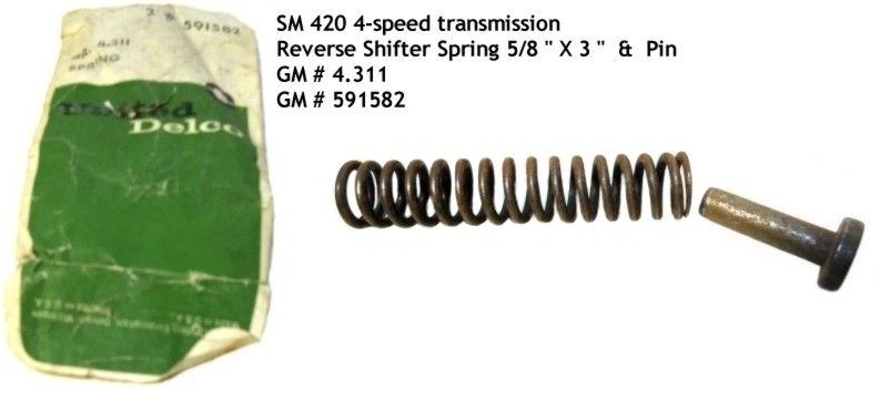

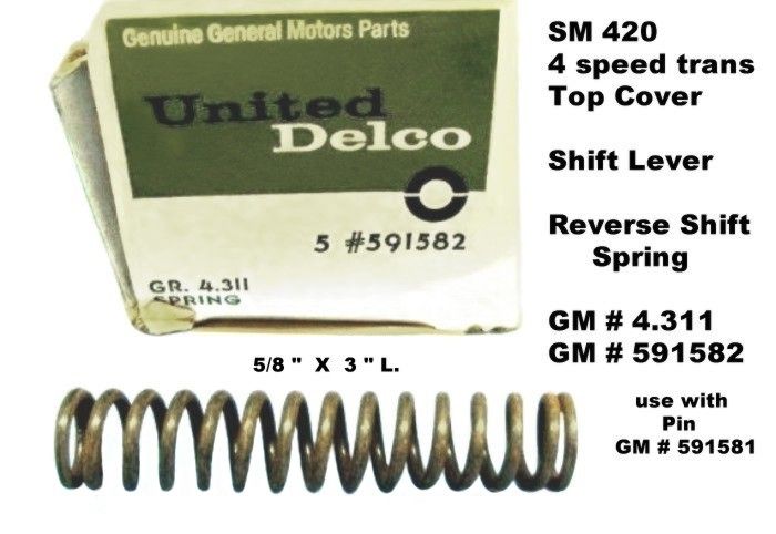

Reverse Shifter Spring - GM # 591582 & Pin - GM # 591581
http://i669.photobucket.com/albums/...erse_Shifter_Pin_GM_NOS__zpsxvukuirx.jpg
http://i669.photobucket.com/albums/...ter_%20Spring%20GM%20NOS_zpsohai3y2d.jpg
Friesens Chevrolet has ( 2
) GM # 591582 Reverse Shift Springs in stock
Dan's GM Obsolete has ( 4 ) - GM # 591582

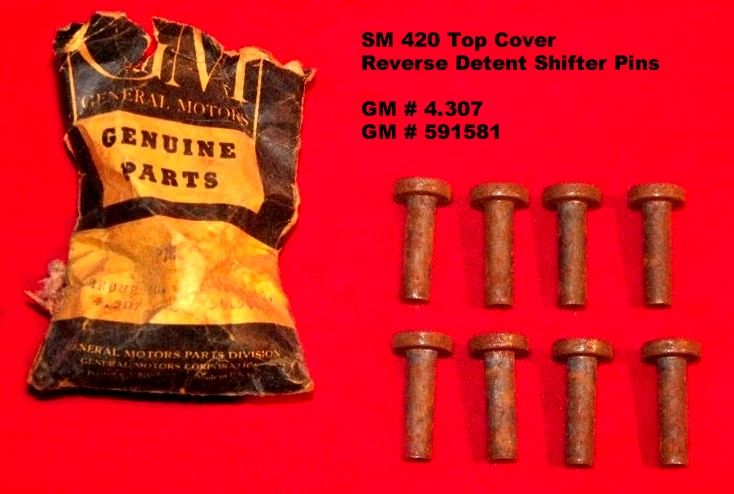

Reverse Shift Pin - GM # 591581
http://i669.photobucket.com/albums/...erse_Shifter_Pin_SM_420__zpsjmei5kkm.jpg
Friesens Chevrolet has ( 4 ) - GM # 591581 - Reverse Shift pin
Dan's GM Obsolete has ( 6 ) - GM # 591581
