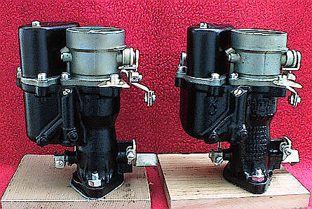

As an addendum to the above post: The URL http://www.thecarburetorshop.com/CarterW1comparison.jpg is a picture of two Carter model W-1 part number 574S (1946 - 1948 Chevrolet). The one on the left was built by Carter in St. Louis, the one on the right was built by Chevrolet in Flint. Look close, and you can see the large letter "C" in the center of the end of the bowl on the carburetor on the right. I apologize for the quality of the picture. I have not yet mastered the digital camera with contrast in black.

Maybe I can shed a little light on the subject, as my family's shop was very active in the carb rebuilding business in the 40's, 50's, and early 60's. Carter was NOT pleased when Rochester started equipping GM vehicles with original-equipment carbs in the early 50's and the owner of the company vowed to sell a million replacement carbs for Chevy vehicles! That's why so many retro-fitted vehicles are found with Carter carbs now. Even as late as the Quadrajet days, some QJ carbs were manufactured by Carter to satisfy a "restraint of trade" lawsuit against GM by Carter! Somewhere in the massive repair manual library left over from the family shop, I believe there are some original Rochester, and Carter repair manuals, so I'll try to do a little research on this thread.
