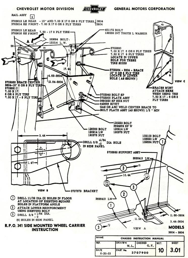

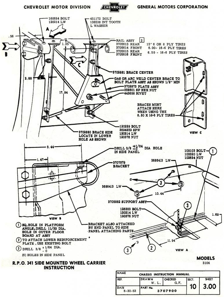

I am guessing with this answer: the Factory Assembly Manual has a poor picture of the side-mount spare tire assemblies (Section 10; Sheets 3.00-3.01). I think that the two bolts through the top of the frame rail and the two bolts through the bed side (above the floor) are flatish-domed phillips-head bolts.
This is the way they came on the three assemblies that I have worked with (who know if they were original-style bolts by the time I got them).
Tim

The Factory Assembly Manual shows the hardware for 54/55, just as described by MM472.

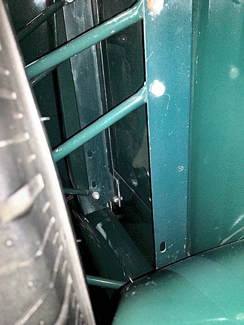

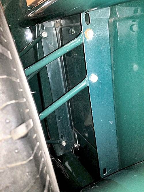

Denny's photos showed the original bolts, but the mount is for his 3604, not for your 3104. The 3104 mount has the two braces at the top. The 3604/3804 mount has the two braces at the bottom. I don't know the difference between Rail Assemblies #3705613/3705614 for narrow tires and #3705615/3705616 for wide tires on the 3104 and 3604/3804 trucks shown in the FAM.

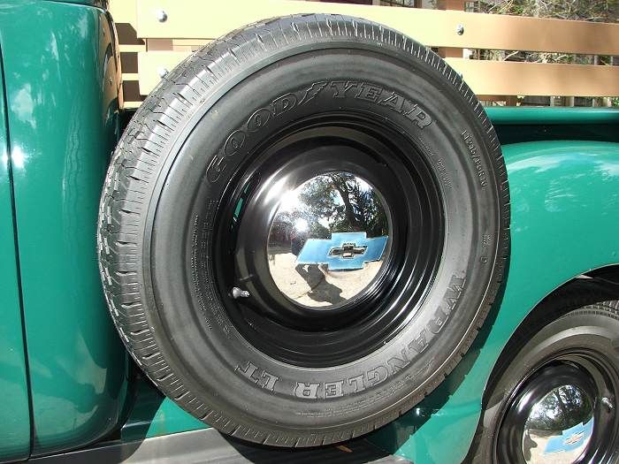

FWIW, my spare touches the fender. LT 215/85R-16. Originally had 6.50X16 (heavy duty rear spring)

I didn't even notice that. I do have the correct mount just wondered what the bolts looked like that attached it to the bedside and what the bolt looked like that held the 3707579 bracket to the top bed rail.
Joe
