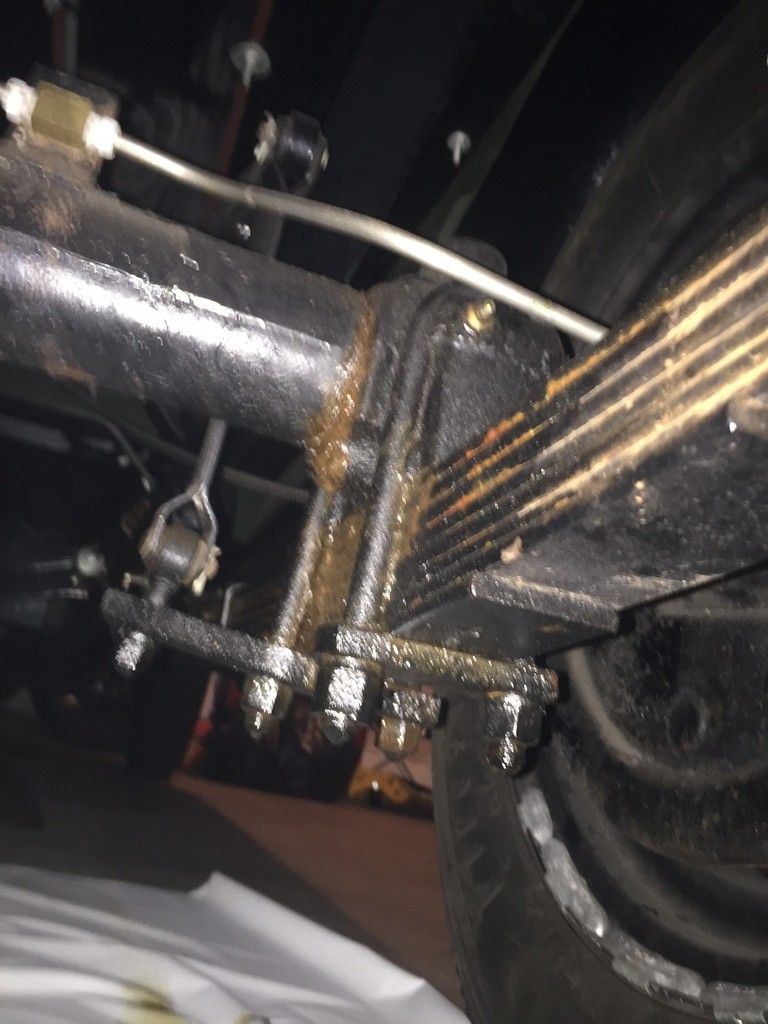

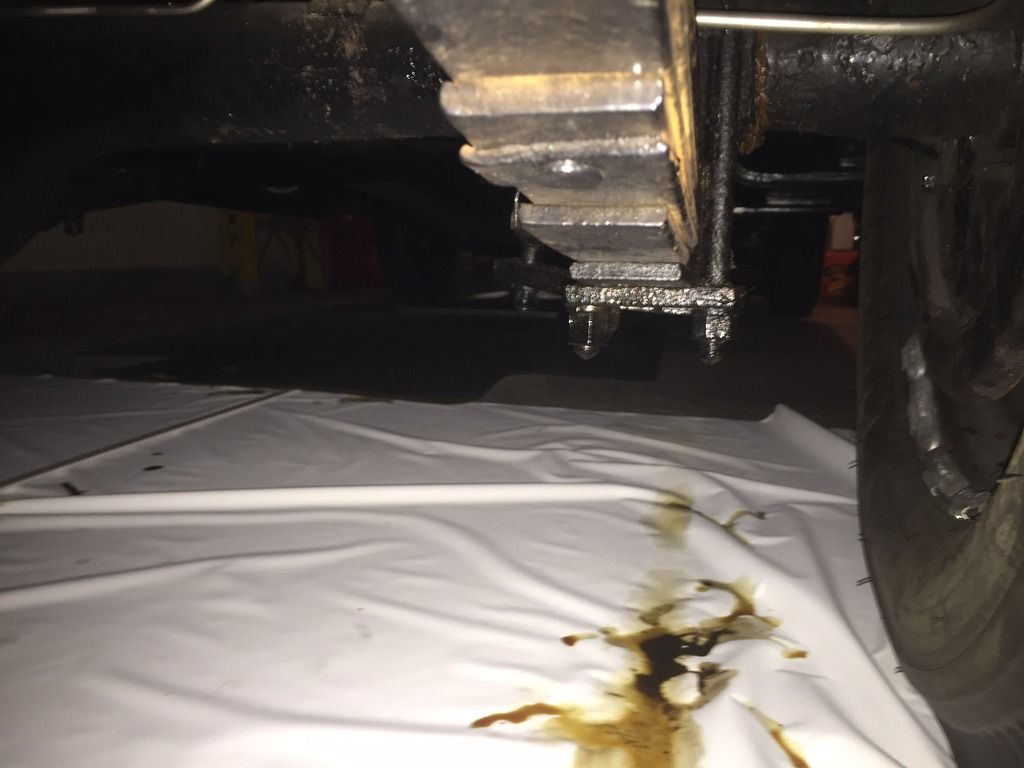

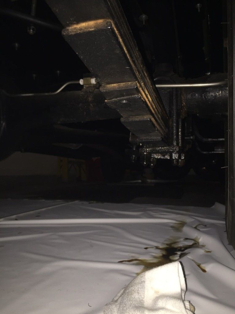

A few years back, I changed out the leaf spring bushings on all four corners of my '46 1/2 ton. In the last year, grease has begun dripping out in mass quantities on the right rear end mount as you can see in the pictures. What would cause this? Is there some sort of part or reservoir that should be in there to hold the grease? Why would it drip out? It is not a leaking wheel cylinder or wheel seal. It drips directly down from the mounting bolts with no path connecting it to the backing plate or wheel. I hope I explained the issue and the pictures below should help. Any help is appreciated.

Same thing was happening on my '37 Chevy half ton project when I got it. That is gear oil from the differential/axle. As you probably know, the rear axle bearings are lubricated by the differential gear oil that sloshes down the axle tube. The rear axle housing rotates on the brackets that hold the axle to the springs, that is why you have a grease fitting, seen in your first picture. Those brackets have an internal slot machined in them where a spacer rides, to keep the axle from sliding side to side. That spacer is held in place to the axle housing by two large rivets, the heads of which are inside the axle tube. As the assembly wears, it deforms the rivets and/or elongates the holes in the axle tube allowing gear oil to seep onto the springs.
To fix that you would have to dismount the axle and remove the axle shafts. Using a piece of pipe as an anvil, placed into the axle housing from the side, we reset the rivets by hammering on the spacer. That tightened things up and I recall using a sealant around the spacers in addition. So far so good but I haven't put much mileage on the project yet.
It shouldn't hurt anything to leave it be, just put a pan underneath and keep an eye on the gear oil level. You can fix it later when need to do some other repair involving the rear axle.

I don't know of another way to fix it. It will be a big job because to remove the axle housing you will have to disconnect the u joint behind the tranny, in addition to removing the rear u bolts and disconnect the rear brake line. You must also remove the axles from the housing. You will then have the rear axle housing, differential and torque tube as an assembly. The only other hard part will be finding the right sized pipe (around 3 inches as I recall) to just barely fit inside the axle housing to act as an anvil on the head of the rivets that hold the spacer. On mine we flattened the rivet heads sufficiently that the spacer no longer moved around in the wallowed out hole in the axle housing through which the oil was leaking. For added measure we applied sealant around the spacer although I am not sure that alone will help much.
