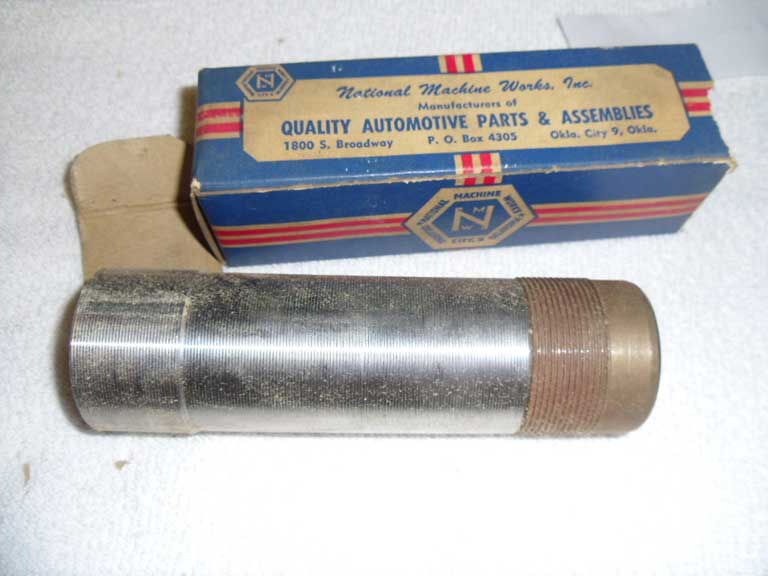

Gary , I could not find a PIC of GM # 596907
but........I found a few photos of an aftermarket bushing
made by the Wohlert Corp. in Lansing, MI .
Maybe you can post a few photos of the GM NOS bushing when you get it .
see PICS
https://s26.postimg.org/k53qs7dax/596907_a.jpg
https://s26.postimg.org/salsqdop5/596907_b.jpg
https://s26.postimg.org/8sr5ahp7d/596907_c.jpg
The above bushings are for sale on ebay right now .
Go to ebay & in the search box.......type......596907
George

A little useless information:
Wohlert might have been one of the companies that made the original Okie Bushings for the torque-tubes (enclosed driveshafts). There was/is some disagreement as to who owned/owns the original/valid patent (National Machine Works, Oklahoma).

George, the photo you show in the first posting has the same part #, but the diagram on the box shows the inner diameter of 1 7/16.
The parts manual Tim referenced lists it as being 1 9/16
Do you know why the same part number has two different diameters? I'd love to get one too, but the smaller size worries me unless there's a reason I'm just not picking up on.
Thanks!

Good Question !
I did not check on the size difference .
I saw 596907 on ebay .
Why would GM have two different sizes for the same part # ?
I sure as heck don't know .
Call one of the other parts sellers & get one of their GM NOS bushings & have them check the size .
I'll leave the post right there .
Maybe someone else can figure it out .
I just went to ebay , I see the bushing is listed as: 2W - 596907 .
Was there a GM part # like that ? I think NOT .
I just sent the seller on ebay a question asking him to measure the bushing length .
I'll post back if he answers me .
Maybe the number on the box is worn ? Making the 9 look like a 7 ?
George

I think 1 7/16" is the width or length of the bushing.
The I.D. shows 1.602 to 1.603 picture
1 9/16" converts to 1.5625
1 39/64 converts to 1.6094
1 5/8" converts to 1.6250
The bushing in the picture is real close to the NOS 1 9/16" I.D. in the parts manual.
I would buy the GM NOS part.

Paul , I received an answer from the seller on ebay .
Here's what he has to say about the measurements .
Gary O. will sell you one of his spare bushings .
https://s26.postimg.org/xg1pfqqqh/596907_d.jpg
ebay message I received.......below:
Hi George
I just measured the inner diameter and it is 1 9/16. You're right, the LENGTH is 1 7/16th. Unfortunately it has sold to another buyer. Thanks for your interest.
