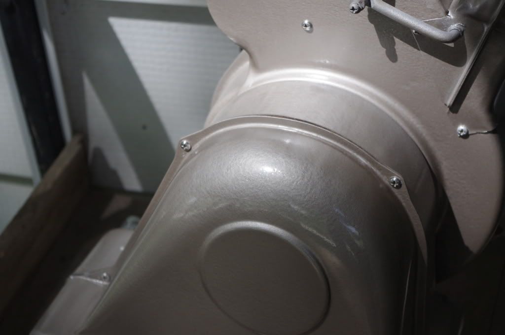

http://i891.photobucket.com/albums/ac112/Twotone_photos/My%20truck/IMGP1135.jpg This is Hammerite Rust Cap 41185 hammered bronze on my heater.

I just wanted to ad that someone gave me some excellent information, but I can't find the post or PM that was the source. I can tell you that I've bought the cans for the interior and the heater, but have not gotten the steering wheel/column paint yet.
Here are what I was shown, I believe by DADS50 (???). Interior (dash, etc)- Rustoleum "Metallic Dark Bronze" part #7272830; and for the Heater casing Hammerite 'Rust Cap' "Hammered Bronze", part #41185. The steering wheel/column are a darker color. I've already done the heater, and it looks excellent.
I found both of these at an Ace hardware store, although they had to order them since they didn't have them in the store, but you may check Wallyworld or someplace since you've got the numbers. Hope this helps. Lee
