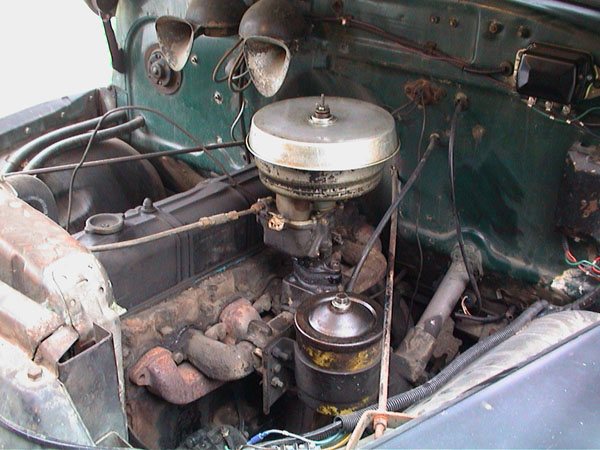

Hello, wondering if anyone has ever converted their oil bath air breather to a paper filter using the original breather. I have read of some pros and cons about using a air filter vs. the oil bath but I think in the end a paper filter is cleaner for sure. I like the look of the oil bath breather so I was hoping to use it instead of changing it out. Any thoughts? Kevin

A good thing to do unless it's a super rare one. Paper is much better. This is a very common modification. The modification differs depending on oil bath. The mod is straight forward. Tear out what you don't want and leave what you do. Find a round style paper filter that fits.
There are lists on the web with sizes and part numbers.
Paper is easier to deal with.
"I have read of some pros and cons about using a air filter vs. the oil bath but I think in the end a paper filter is cleaner for sure."
I think that the oil bath air cleaner is at least as effective in cleaning air as any paper/dry filter. And, they have a non-clogging advantage over other types of filter elements.

Kevin,
My oil bath air cleaner was a mess. The engine kept drawing the oil out of it, causing all kinds of rough running issues. Recently, I learned there should be a rubber gasket in the bottom of it?
I removed the oil bath filter element and purchased another late model Chevrolet air filter top. Next, I went to my FLAPS and purchased a NAPA Gold 2193 air filer.
The new air filter works great and no more oily mess!

I have a filter like Andy pictured above. I replaced the entire center section with a Fram CA148/equivalent. No cutting involved and I have the complete center section intact if I ever want to reuse it. Simple.

Just use the base shown on right in Andy's picture and the original top. Filter is 3-1/4" tall an 1" is exposed with the top on, similar to Andy's completed picture.

Appearance the same as Andy's except I used the original cover. The paper filter simply replaces the washable oil filter element. I'll see if I can figure out how to post a picture.
