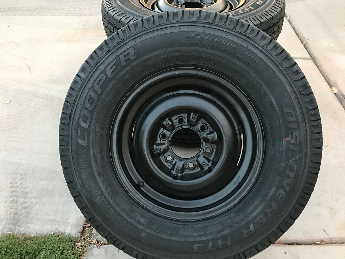

Well, thanks to my AMAZING neighbor, got the rims blasted and powder coated for free. Well, I bought him and his wife a $50 gift certificate for Joe's Farm Grill here in Gilbert. Went ahead and broke open the piggy bank and put on some new tires also. Not the cheapest route, but one that we are both happy with.
Baby's got new shoes!
Up close
Up closer
Got them on the truck after work. Will be rolling the truck out of the garage this weekend for some more pics and a proper bath.

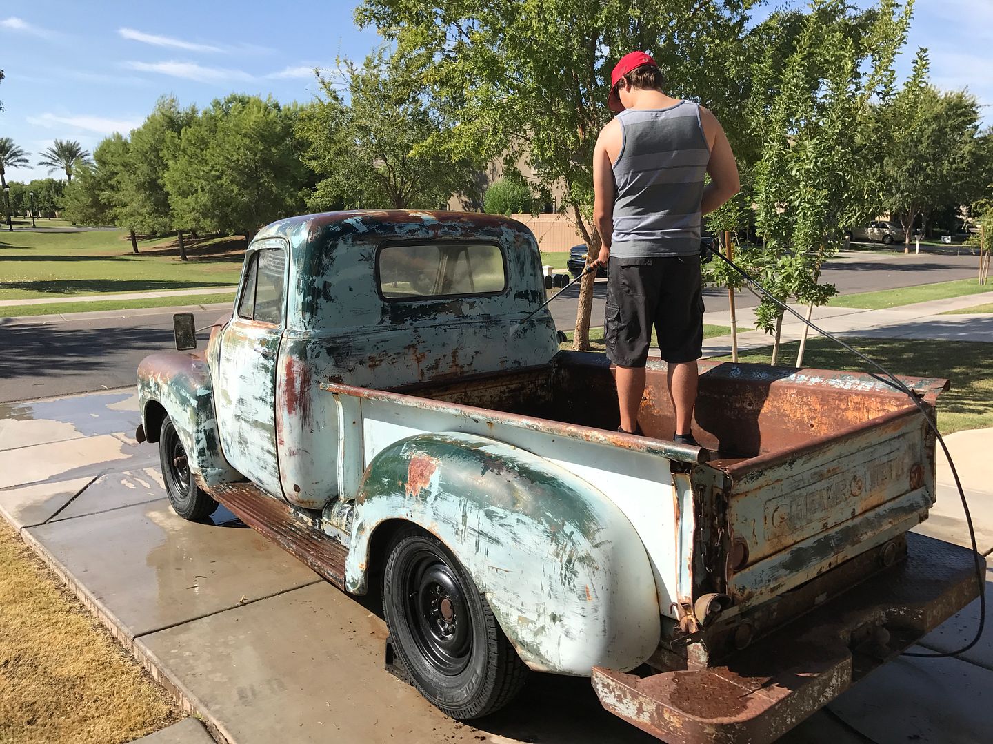

He is Ryan spraying off a few layers...
Bath time
