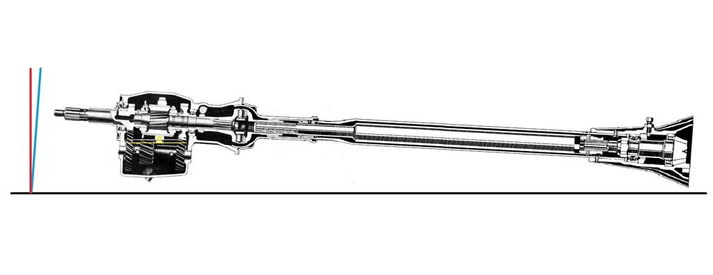

Q.Does the transmission fluid flow into the torque tube on the 46 1/2 ton setup?
A.Yes, But only about 8 inch into the front of the torque tube.
Q. Is there a seal at the back of the transmission that keeps the fluid from going into the torque tube from the transmission?
A. No, the oil seal is in the torque tube.
Q. What kind of seal is it (are they) and how hard is it to replace?
A. Neoprene seal , Yes if its done by the book, No if you use a Okie bushing.
Q. How many universal joints are inside the torque tube on the 46 1/2 ton and how are they lubricated?
A. One U-Joint, By transmission fluid being funneled through the transmissions rear main bearing.
Complete Transmission and Torque Tube cross section
Q. Does fluid flow between the torque tube and the rear end?
A. No
Q. Is there a seal at the back of the torque tube or the front of the rear end that keeps the fluid from going between the torque tube and the rear end?
A. No
Q. How does the knurled slip collar at the front of the torque tube come into play? Does it do any 'sealing' of fluid in the torque tube?
A. Inside the torque tube screw on retainer cap (knurled slip collar) there is a oil seal and one washer on each side of the oil seal.
Which prevents transmission fluid from leaking out of the back end of the U-Joint ball housing.
Torque tube Crosssection Front end
History of the Okie bushing
The Okie bushing was created by the long gone National Machine Works Inc in Oklahoma, hence the name Okie.
It shortened the time and effort to repair the torque tube bushings and oil seal.
If you did it the way GM did it, you would remove the entire torque tube from the rear axle.
Remove ring & pinion gears
Pull out the driveshaft from the torque tube.
Use special tools to remove and replace the bushings and oil seal.
Then reassemble everything. Pain in the Butt.
With the Okie bushing you just pull out the front bushing.
Then from the front of the torque tube you push in the Okie bushing sleeve, which has the Front bushing,
Rear bushing & Oil seal inside the sleeve. Less Work.
Original set-up
Original front bushing removed, Okie Bushing Sleeve inserted
You leave the rear bushing and oil seal in the torque tube.
Okie Bushing Photo Album
