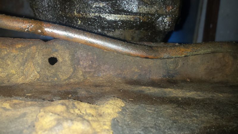

OK how about this one
http://img.photobucket.com/albums/v...eived_10206386782447667_zpsyrpu5sqk.jpeg
Also are these holes in the cross member for the holes in the tranny at the end where it connects to the drive shaft? One hole has road grime in it
http://img.photobucket.com/albums/v678/pdinkle75/Mobile%20Uploads/20160521_194054_zps1witm0gf.jpg

The tranny from the 51 will work.
If I am correct, the 51 truck tranny won't have any place to mount it to a cross member, the bell housing is the rear mount for it. A tranny with a mounting boss on the tailshaft is for a car.
