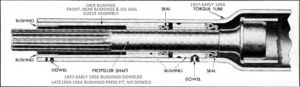

I think the reason you've been having problems.
Is because your 1950 torque tube is ether a 1st design (slip fit) or a 2nd design (press fit).
Sometime in 1950 GM changed the bushings from slip fit to press fit.
To tell the difference the slip fit bushings were held in place with a dowel pin and the press fit were not.
--------------------Rear Yoke Bushing..--Propeller Shaft Bushing
----------------------I.D.Front O.D. ------ I.D.Rear O.D.
1948-EARLY 1950, 1.350---1.720--------1.070--1.685, Slip fit Dowel Pin
Late 1950,----------1.350---1.719--------1.070--1.687, Press Fit
1951-1954,---------1.350---1.773--------1.070--1.725, Press Fit
The above bushing dimensions show the Rear Propeller Shaft bushing I.D. did not change from 1948 to 1954.
But the O.D. did.
Maybe the whole Okie bushing Assembly is turning inside the torque tube. Read number 5
Torque tube housing inside dimensions did have variations.
Call these guys http://nwtparts.com/ Ask for John, tell him what's going on, he has probably encounter this problem before. Smart Dude
Or These guys http://www.vapinc.com/ they make most of the Okie Bushing Assembly's

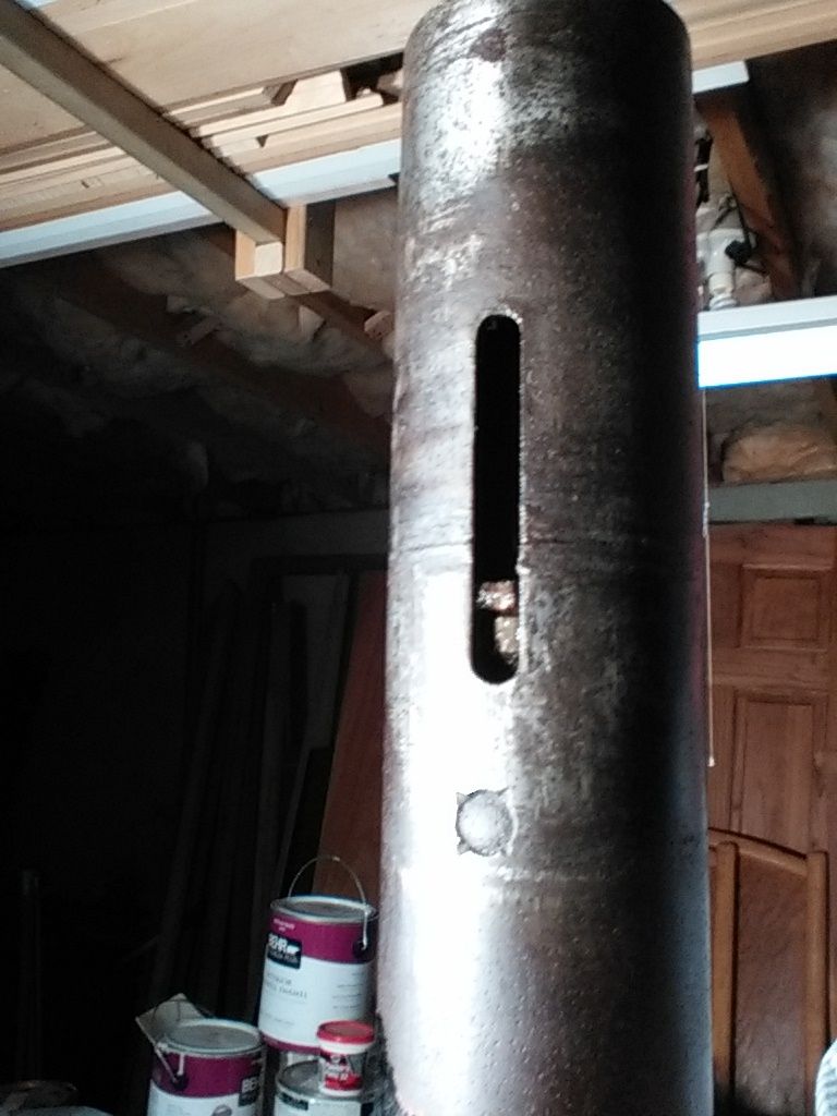

I have to say I have never seen a elongated slot cut into the torque tube housing.
Maybe someone knows why it is there.

I know the slot was used through 1936.
The slot gave you access to drive the rear bushing out.

Thanks guys. The filling station has a tech article that shows the slot on a 30-33 passenger and tells how to drill out the pin and drive the bushing with a punch through the slot. I assumed they all had a slot . I'm pretty sure the rear is a 37, but not positive. Cast number 377707 on one side, and a 2 on the other. I got feedback from someone that it was a 37. Looks like jim carter may have some new oakie bushings just in for a 37. I will check tomorrow on availability and if they are available, the oKies dimensions.

Torque Tube Bushing Replacement Shows elongated slot on Torque Tube
The benefit of this was the ability to replace bushings & oil seal while Torque Tube remained in truck.
My hunch is the reason they did away with the slot was to eliminate oil leaks or to gain strength in the Torque Tube.
1934 Chevrolet Repair Manual
Slot in Torque tube Lower RH corner of page.
Just curious is that slot on the top side of the Torque tube? Meaning: Facing the floor of the cab.

The slot is in the top center line of the tube. On another note, jim carter parts had new oakie bushings just in. I purchased one and should get it by Friday. Of note, the od at the front is 1.72 and at the rear is 1.68, which is in concert with the nos bushings I have and the info from the chevrolee database exactly. They measured it while I was on the phone. Am going to pull the old bearings and get an exact torque tube id. Right now my guess is 1.5 to 1.6 inch. Will have a shop machine it close to the tube dimensions to get a good interference fit, but not so tight I have to force it and maybe do damage. Can't figure out why the dimensions differ if I really have a 37 rear end.

Okie Bushing History
The Okie bushing was created by the long gone National Machine Works Inc in Oklahoma, hence the name Okie.
It shortened the time and effort to repair the torque tube bushings and oil seal.
If you did it the way GM did it, you would remove the entire torque tube from the rear axle.
Remove ring & pinion gears
Pull out the driveshaft from the torque tube.
Use special tools to remove and replace the bushings and oil seal.
Then reassemble everything. Pain in the Butt.
With the Okie bushing you just pull out the front bushing.
Then from the front of the torque tube you push in the Okie bushing sleeve, which has the Front bushing,
Rear bushing & Oil seal inside the sleeve. Less Work.

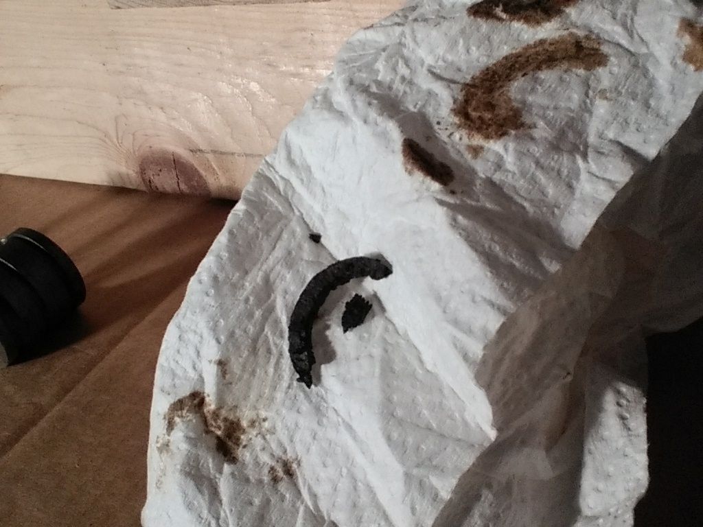

I added some photos in photo bucket that show the okie has the same or as my torque tube, and shows the bushings, front is bronze , and rear, with the two grooves and the cork remnants I removed.
Was just the CORK oil seal inside the torque tube and no Metal washer retainer Fig. 32.
There should have been (in the order of what is installed first)
Washer retainer
Cork oil seal
Rear bushing for propeller shaft.
Front bushing for rear U-joint yoke.
If you use the rubber oil seal there is no need for the Washer retainer.
Note: This SIDE of the oil seal should be installed facing toward the axle.
And should be driven in until it stops at the seat inside the torque tube.

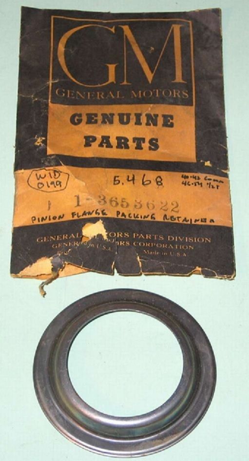

There is one difference that I know of, from the older year truck axles to the newer year truck axles.
GM started using a oil retainer in front of the rear pinion shaft bearing. You can see it in this Illustration in front of number 4 arrow.
To retard or slow the return of gear lube back into the axle housing.
Assuring the front pinion shaft thrust bearing is in a continuous bath of gear lube.
Passenger car axles, I believe never used a oil retainer.
The Chevrolet's 1938 Shop Manual - Cut away illustration shows that there was no oil retainer.
