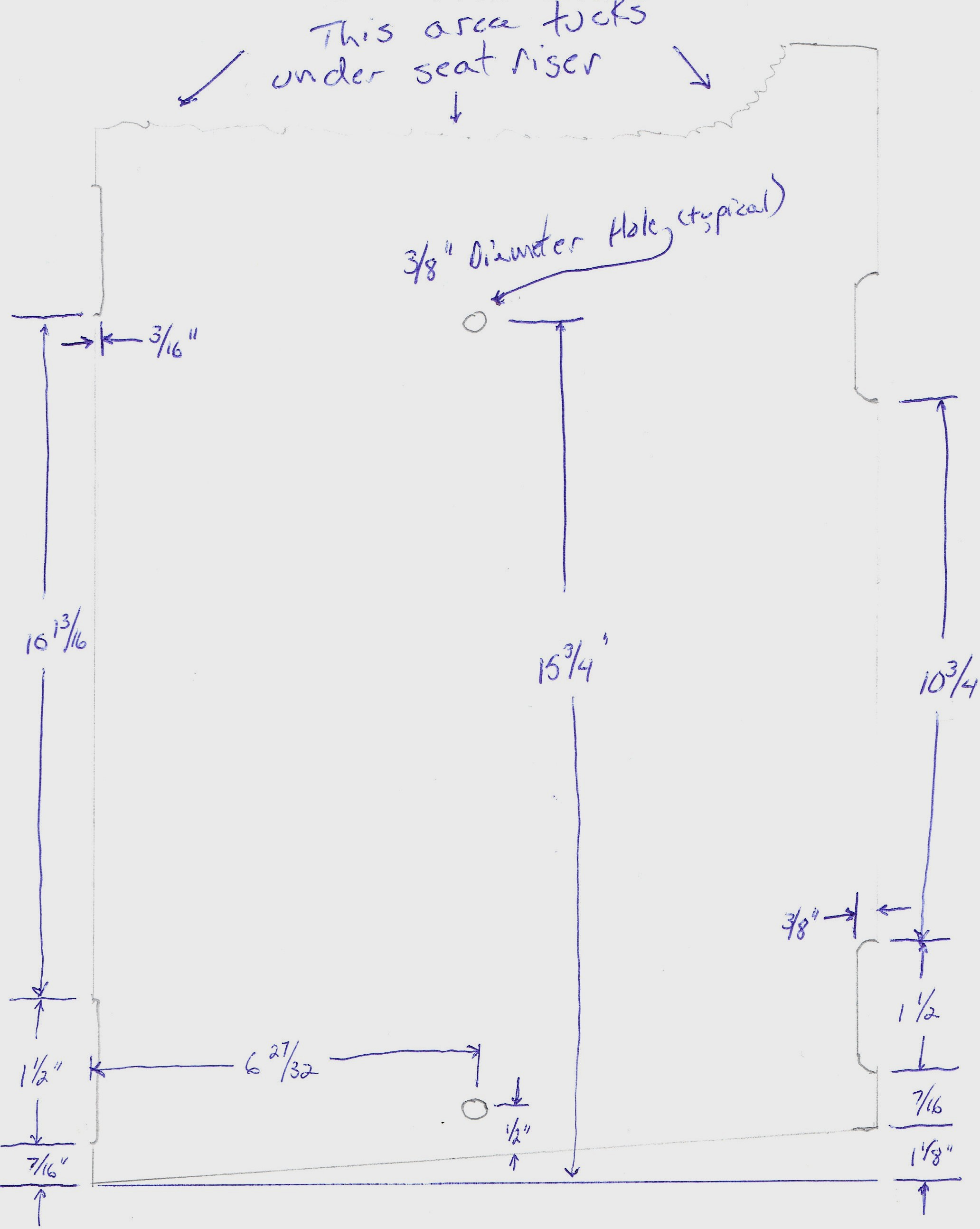

Does anyone have the exact location for the jump seat brackets?

Nobody knows the location dimensions of the frt. Passengers seat?

oldburbs,
I could measure mine when I get to see it next week.
But, I had parts of my floor replaced, and I did not know where the seat should be located. So, we mounted the drivers 70% seat and then placed the jump seat on the floor. We simply placed aluminum "skids/lifts/risers" under the jump seat's base, until it was level with driver's seat. We then bolted the skids/risers through the floor and the base of the jump seat to (or through) the "skids/risers".
Does your Suburban have a rough-cut-looking metal plate/base attached to the floor under the jump seat? Mine had been removed.
I think bowtietim posted a photo of the rough metal plate under the jump seat?

oldburbs #1160226 04/13/2016 9:44 PM
Nice, Mark - thanks
What is the thickness of that plate?

It measured out to somewhere around 14 gauge.
