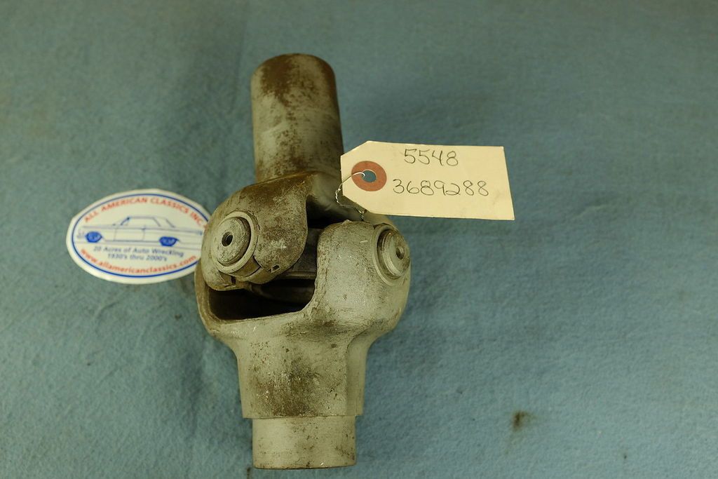

Is this what you need ???
A friend of mine bought this one on ebay in 2013
for his 1950 3600.
photo@photobucket
http://i669.photobucket.com/albums/...l%20Joint%20GM%20NOS%202_zpszfixk9gu.jpg
If that's the part you need.
Dan's GM Obsolete
Chinook, Montana
phone: 406-357-2615
Dan's has ( 6 ) GM NOS - GM # 3689288 in stock.
You can also send Bruce Bugay in Virginia an email.
He may have one. Give him the part number.
email: [email protected]
Bruce buys & sells Chevy parts in his retirement,
There's one on ebay now @ $69.95
Go to ebay & type in the part # in the search box.
This one on ebay.....in the description
it says, USED ! Plus $18.65 shipping
That's $88.60 for used in unknown condition.
To me that's a lot of money for used.
I'd rather have GM NOS. But everyone to their
own way of doing things. Most here on stovebolt would
rather have used or made in china parts.
ebay USED U-joint
photo@photobucket
http://i669.photobucket.com/albums/...0Ujoint/3689288_on_ebay__zpsr0v6yind.jpg

Here's a link to a brand new GM NOS
FRONT u-joint assembly for your 1950 3/4 ton.
$150.00 & free shipping .
http://www.ebay.com/itm/1947-1954-Chevy-Truck-U-joint-3-4-Ton-4-speed-NIP-/151923432563?vxp=mtr
At this price considering how rare this part is.
I think I'd grab it asap !
ebay seller has a make a BEST OFFER option.
Offer him a $100.00 & take it from there.
Ya' snooze....You lose !
George
'54 3600
NOTE: THIS RARE PART SOLD ON ebay on 1/09/16
@ 7:29am for $150.00
IF YOU SNOST.....YA' LOST !
