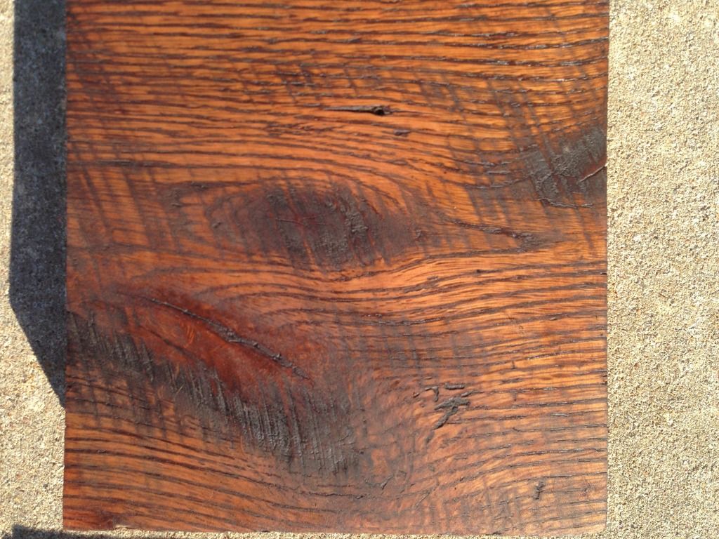

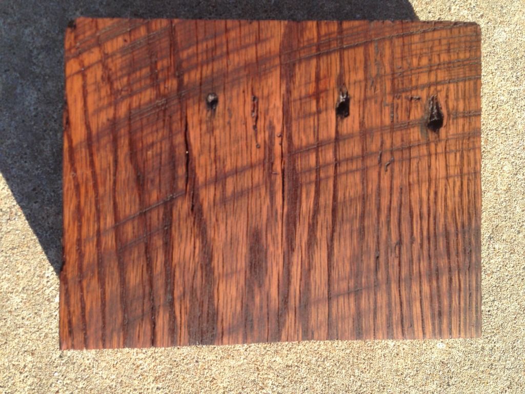

I did a few test runs on color, the first one I applied a walnut stain the lightly sanded and then applied a gun stock stain. second one is an early american with coat of gunstock stain.
http://i1062.photobucket.com/albums...9-4A76-9C43-62124AB00444_zps2hbnyrr6.jpg
http://i1062.photobucket.com/albums...1-48F2-A42B-D0A129984C4E_zpsv3yzwpgb.jpg
http://i1062.photobucket.com/albums...2-4601-B020-8E2ADA3E362A_zpsbn7trfja.jpg

Bryan,
That wood (and finish) looks incredible!
Edit - I think that first piece is knotted heart pine; but I could be wrong. Also, apologies for listing stain color names after you clearly wrote them in your previous post...I missed that.

Posts: 208
Thanks Brad, will continue to fine tune the color. Fairly sure its red oak... but then again seasoned barn wood of all types looks the same to me until I get that top coat of oxidization off and look at the grain.
