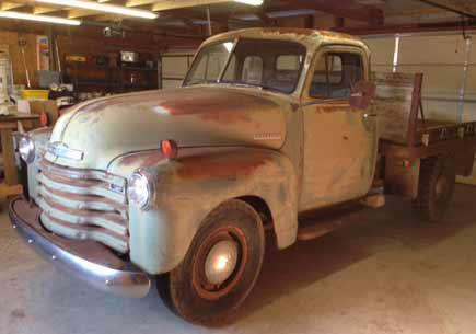

So after many months and many trips to look at trucks that ended up being way to high on the rust-to-money ratio or just had too many parts missing, I stumbled across one in a Craigslist ad in neighboring Arkansas. It was a 1949 Chevy flatbed with a hydraulic lift. I liked the oddity of it, not your run of the mill pickup truck.
I looked at several others but kept coming back to it. I finally convinced my wife to take a Sunday ride down to Northwestern Arkansas to look at the truck. I immediately loved it! The truck had not been hacked up over the years. The fenders had no rust and were in excellent shape, except for a few small dings. The cab only had a few spots of rust in the typical areas in the corners. The bed had a sheet of steel welded over the wooden bed slats.
The seller fired it up for me and outside a few leaks, it sounded good. So we agreed on a price, shook hands on it and 24 hours later it was sitting my garage. (May I add, "your large detached garage" ... oh, such joy ... it's like having all the tools you need to do the job right! ~ Editor)
I walked circles around it for what seemed like hours, taking inventory and  making a list of all the items I would need and what order, deciding what I would tackle first.
Now for the fun part: I started tearing it all apart.
As the parts started coming off, I started questioning what I knew to be true about my old truck. As I stated before, I am a beginner when it comes to telling the differences in years. So I started asking questions in the Stovebolt forums and I had all kinds of help from the members.
The chassis was indeed from a 1949 but one of the doors was from a 1951 and the cab I strongly suspect is a 1952. So now my 1949 Chevy pickup truck was starting to sound line a Johnny Cash song! Quite the mutt. With all that being said, I am still having a blast working on it.
